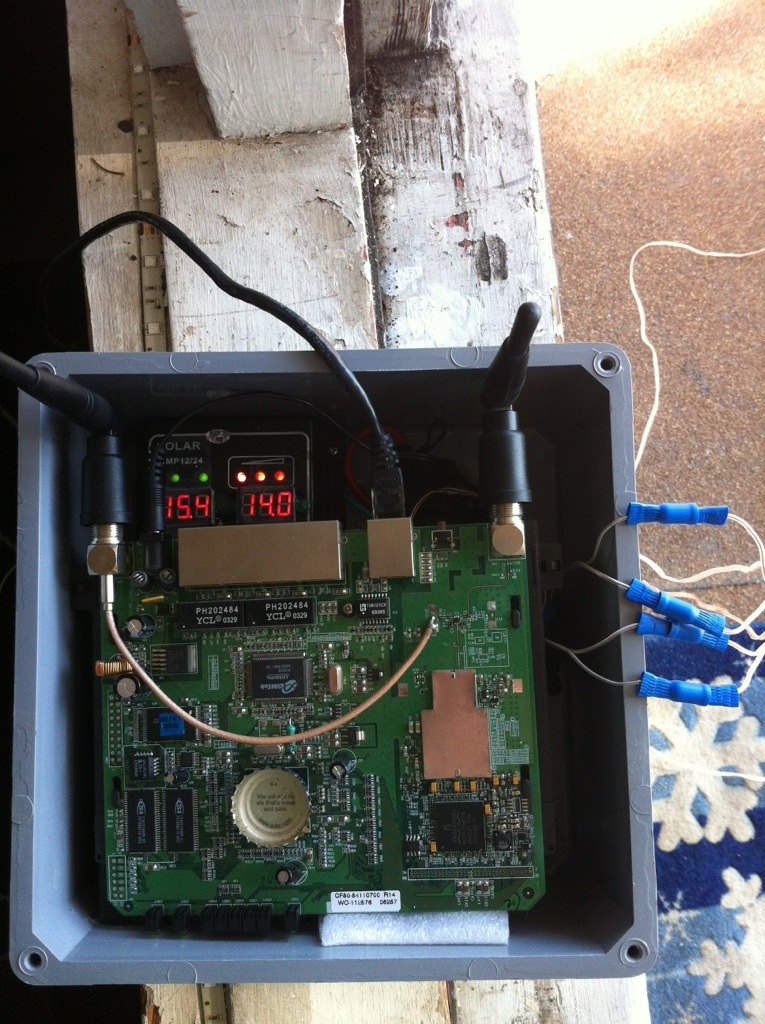

i built one too. here is how http://lagunabeachcomputer.com/solar-powered-linksys-wrt54g-router-w-dd-wrt-and-hotspotsystem/
it uses 2x 10 watt panels, a 7.4AH 12v battery and a charge controller

Great! How does it perform?
Will it last a couple of days without sun?
I presume you seal it up when you're not showing it off?
Is that a bottle cap being used as a heatsink?

so the two 10 watt panels will certainly power + charge the battery in full sun but it takes all day long for a full charge. In fact it might even come up a little short. I turned it on today at 5pm, battery was trickle charging at 14.0v , so i expect it to go almost all night and some of the morning.
It would certainly benefit from an additional 3rd solar panel. I think it just needs a little more charge power to fully keep the 7.5ah battery at its max use. You could probably go 12 hours easy i think. Otherwise you could just add batteries like 1.4AH till you get your desired run time...
