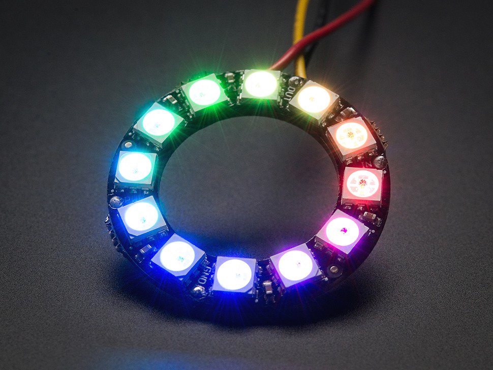

Something like a neopixel ring would be nice but it's not very child friendly and requires significant power.

Yeah KJ, the neopixel looks nice, but the battery outside makes it difficult to wear around the finger. Thanks though.
