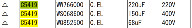

This is all I see for C5419 in the service manual and my best guess is that I need to add up all the pink voltages to get the value? I'm just guessing.

Nope - the pink voltages have country-specific values, J-Japan, U-USA, G-United Kingdom etc. If you're in the USA it should read around 165V. 500V is Waaaaayyy too high! Sure you're using the meter correctly and/or that it's working correctly?

Oh, whoops I was using AC I think instead of DC. I redid it and it showed around 165 so that capacitor is good.
