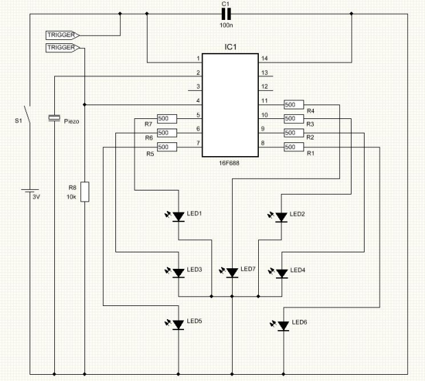

schematic
Parts List
R1                   500 ohms resistor
R2                   500 ohms resistor
R3                   500 ohms resistor
R4                   500 ohms resistor
R5                   500 ohms resistor
R6                   500 ohms resistor
R7                   500 ohms resistor
R8                   10K resistor
C1                   100nF cap
Led1 to 7        5mm flat led
Piezo               Piezo HPE-120
IC1                  16F688 microcontroller from Microchip
S1                    Normal On/Off switch

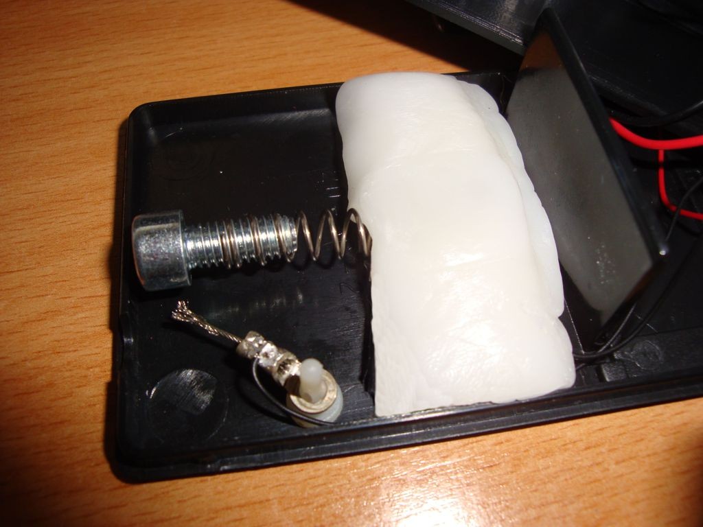

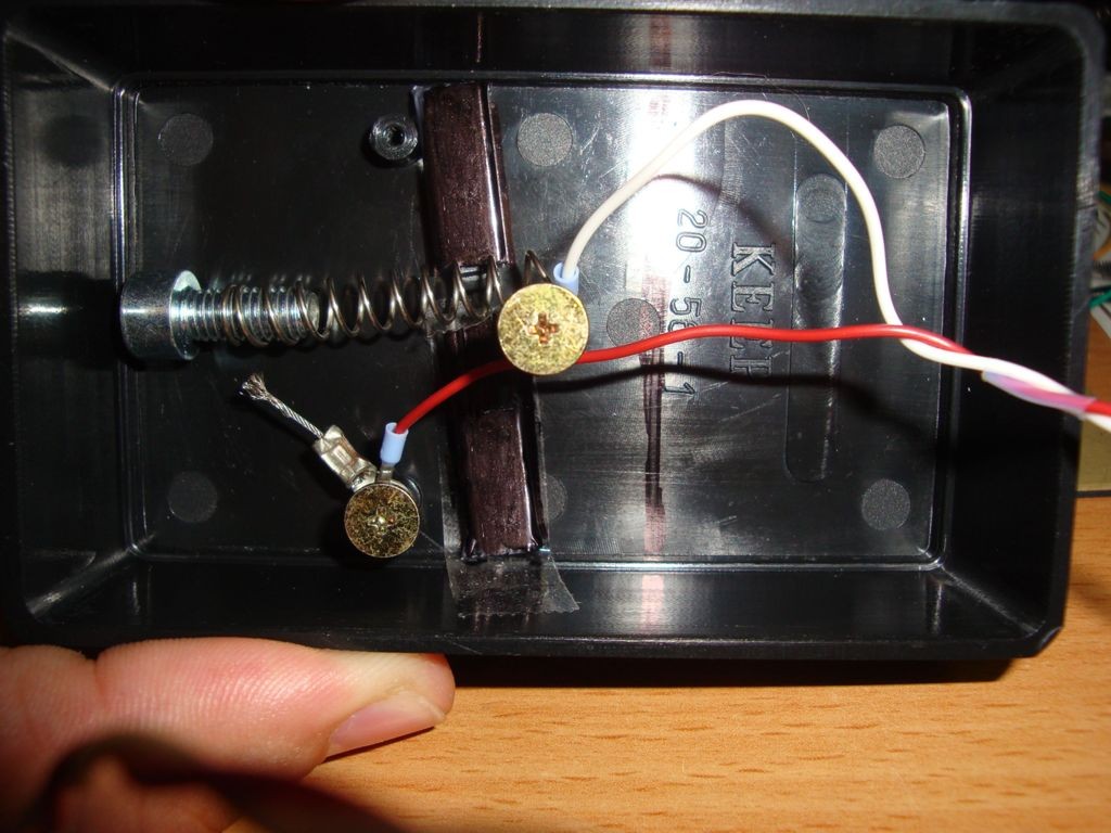

The Trigger
The trigger is a mechanical device and it will sense the shaking movement. One contact will be on a spring and the other contact will be on a wire. The spring has a screw on it’s end and it will act as a weight. Placing the box on it’s side, the spring needs to have enough strength not to bend with it’s own weight. Shaking will make the spring to move and touch the wire closing the circuit and this way the microcontroller will know when it’s time to roll the dice.
photo_1
Adding a small amount of polymorph will secure the spring and give a better final look.
photo_2
Hex Programm
The Hex program must be saved in the microcontroller’s memory before soldering on the PCB.
The fuses OSC and MCLR fuses must be set as follow:
INTOSCIO                 on
MCLR                         off

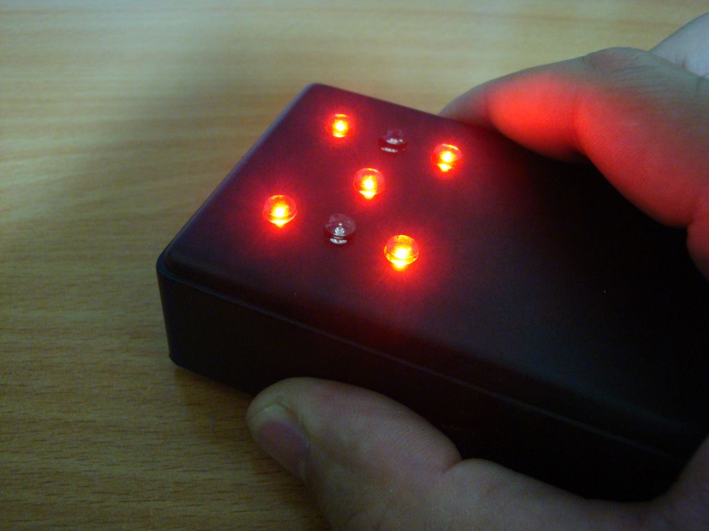

Testing
Turning on the circuit, the microcontroller will initialize and light on and off all leds.
Shaking the box will roll the dice. The leds will simulate the rolling of the dice and the piezo will sound until the final number is displayed.
Once the final number is displayed it’s possible to sort another number simply by shaking the box again.
