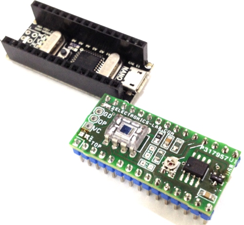

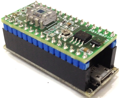

Multi Sensor Shield for Arduino Nano with Light, Magnetic Field & Temperature Sensor
This Arduino Nano Shield consists of a Light sensor, a Magnetic field sensor, and Temperature sensor. The shield can be used to develop various projects required light sensing, magnetic field sensing, and temperature sensing.
This Arduino Nano Shield consists of a Light sensor, a Magnetic field sensor, and Temperature sensor. The shield can be used to develop various projects required light sensing, magnetic field sensing, and temperature sensing. All sensors provide analog voltage outputs, so each output is connected to analog inputs of Arduino Nano.

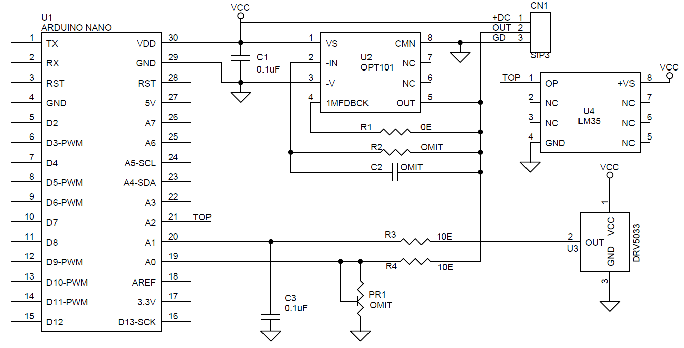

Sensors
  • OPT101 High Sensitive Light Sensor with Adjustable Gain ( Analog Output)
  • DRV5053 Magnetic Field Sensor ( Analog Output)
  • LM35 Temperature Sensor ( Analog Output)
Arduino Nano Interface
  • OPT101 Light sensor output connected to Analog pin of Arduino Nano
  • Magnetic Field Sensor output connected to Analog pin of Arduino Nano
  • LM35 Sensor output connected to Analog pin of Arduino Nano
Output
  • OPT101 provides 7.5mV to 4V ( Minimum Dark Output 7.5V)
  • DRV5053 Magnetic Field Sensor Output 0-1.8V
  • LM35 Temperature Sensor Linear + 10-mV/°C Scale Factor
Power Supply:  All Sensors connected to 5V of Arduino Nano
