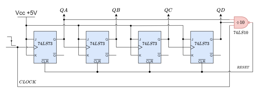

It is possible to create a decade (divide-by-10) counter output for use in common decimal counting and arithmetic circuits by modifying the modulo-16 asynchronous counter with extra logic gates.
More precisely, these counters are called “Decade Counters.” When the output count hits the decimal value of 10, or when DCBA = 1010, a decade counter must be reset to zero. To accomplish this, we must send this condition back into the reset input. Although binary decade counters are more frequent, a counter with a count sequence ranging from binary “0000” (BCD = “0”) to “1001” (BCD = “9”) is commonly referred to as a BCD binary-coded-decimal counter since its ten-state sequence is that of a BCD code.
Asynchronous Decade Counter
Fig-2: Decade Counter

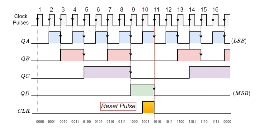

Starting from 0000 and counting higher on each trailing edge of the input clock signal, this kind of asynchronous counter continues until it reaches an output of 1001 (decimal 9). QA and QD’s outputs are now equivalent to logic “1”. When the subsequent clock pulse is applied, the 74LS10 NAND gate’s output switches from a logic “1” level to a logic “0” level.
This signal resets all the Q outputs to binary 0000 on a count of ten since the output of the NAND gate is linked to the CLEAR (CLR bar) inputs of each 74LS73 J-K Flip-flop. The NAND gate’s output goes back to a logic level of “1,”  since outputs QA and QD are now both equal to logic “0” due to the flip-flops having just been reset and the counter resumes at 0000. Now, we have a Modulo-10 up-counter or a decade.

Decade Counter Timing Diagram
Fig-4: Decade Counter Timing Diagram

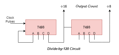

Assuming we were to construct a “divide-by-128” counter for frequency division, we would require seven flip-flops to cascade since 128 equals 27. Even with twin flip-flops like the 74LS74, four integrated circuits would still be required to furnish the circuit.
Fig-5: Divide-by-128 Circuit
Making a four-bit ripple counter by using two TTL 7493S would be a simple substitute technique. TTL 7493S is a 1:16 counter which can be split into 1:2 and 1:8. One 7493 might be set up as a “divide-by-16” counter and the other as a “divide-by-8” counter because 128 = 16 x 8. As indicated, the two integrated circuits would be cascaded together to provide a “divide-by-128” frequency divider.
