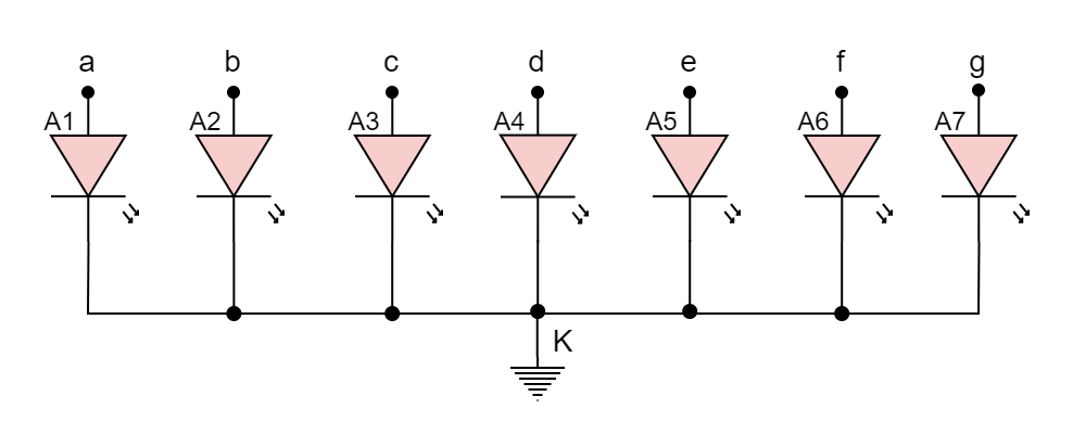

Common Cathode (CC) Configuration
Figure 2: Common cathode configuration
The Common Cathode (CC) Display – All of the cathode (K) connections of the LED segments are hooked together and connected to ground or zero volts in a common cathode (CC) display.
By forward biasing the individual anode terminals (a to g) with an appropriate electric current, the individual segments are lighted. For a common cathode display to function, a drive circuit that can supply current is necessary.

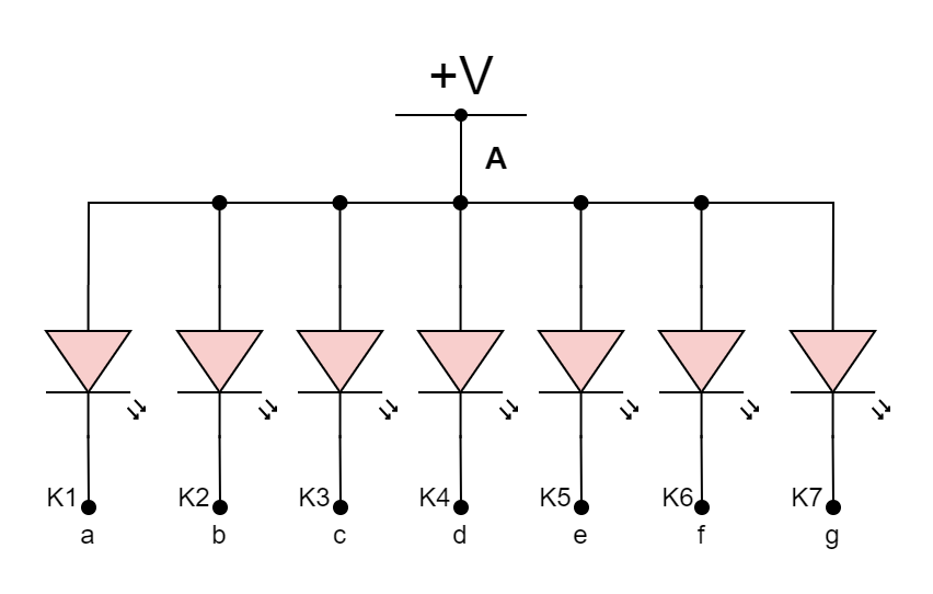

Common Anode (CA) Configuration
Figure 3: Common anode configuration
The Common Anode (CA) Display – All of the LED segments’ anode (A) connections are connected to a positive voltage source in a CA display.
Applying a ground, or “LOW,” signal to the specific segment’s cathode terminal (a to g) illuminates each segment. Therefore, a driving circuit that can sink a current is necessary for a common anode display.

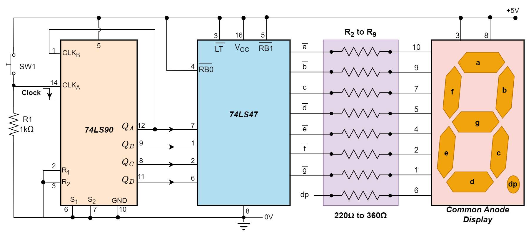

It can be a little tiresome to operate all four SPST switches at once, even if doing so will cause the matching numbers or random characters to appear. Thus, it would be preferable if we had a single integrated circuit (IC) chip—the 74LS90 BCD Counter—that could produce 4-line binary data without the need for four switches.
To generate a BCD output code, the 74LS90 integrated circuit may be set up as a MOD-10 decade (divide-by-10) counter. It counts from 0000 to 1001 before resetting to 0000. This asynchronous decade counter/divider integrated circuit allows us to increase the numbers on the seven-segment display with a single switch, as demonstrated.
Single-Digit 7-Segment Display Counter
Figure 7. Single-digit 7-segment display counter
By simply pressing one pushbutton switch, SW1, 10 times, we can now increase the numbers on the display from 0 to 9. The count may be altered to change when the pushbutton, SW1, is released or activated by adjusting the pushbutton’s location and the 1kΩ resistor.
Our straightforward design demonstrates how to use a 74LS90 BCD Counter and a 74LS47 7-segment display driver to create a 0 to 9 digital counter. However, a second counter stage can be added to this single-digit 0–9 counter to create a two-digit 00–99 counter.
