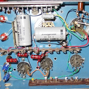

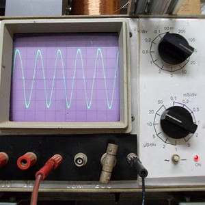

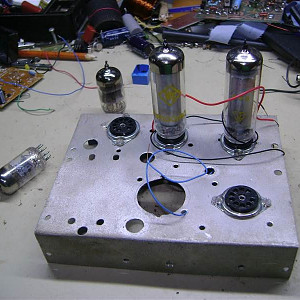

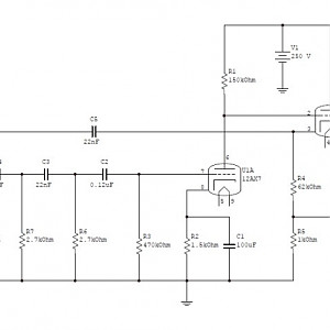

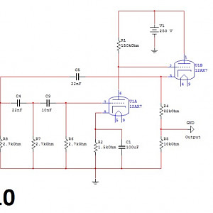

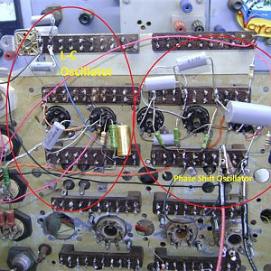

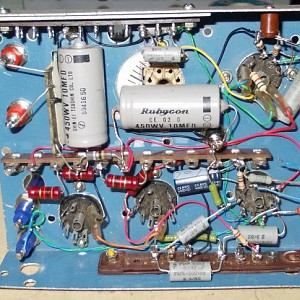

This generator will produce two fixed frequency signals to test electronic devices. It is based on vacuum tubes
