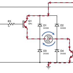

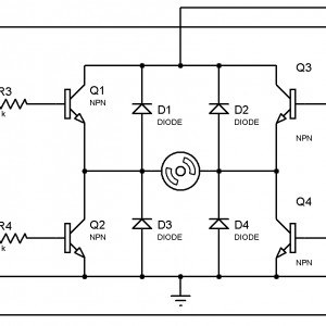

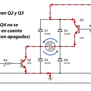

in a speed motor controller by arduino, we substitute the motor for electrodes, we will have an electrolysys machine. Failures are that electrodes solubilize, so, impedance increases a lot, or it becomes open circuit... or some ions sediments&form a short
