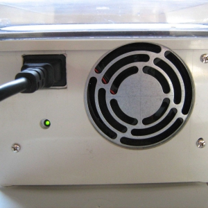

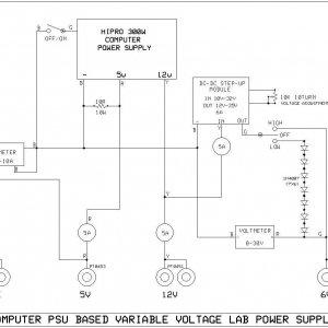

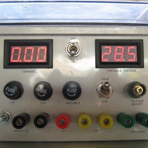

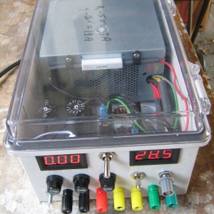

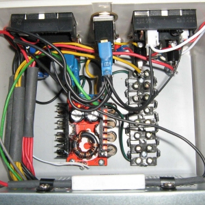

A variable voltage lab power supply for automotive use using a computer PSU.
