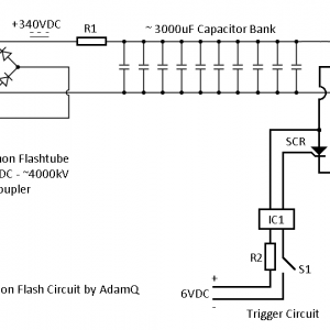

    This is a thread to track and report my progress with my first electronics project, a 200ws high power xenon studio flash strobe. It's a relatively basic circuit, but I am an amateur and no one is ever done learning. I welcome suggestions/feedback!

    Hi guys, It's been a couple days since your very helpful replies, and I wanted to give you an update. Kris, I've gone ahead and implemented the changes in your schematic and replies. Also, I have a 4A fuse protecting the circuit at the power supply that I neglected to include in my...

    Hi! I have a project with a high voltage side (340VDC) and a low voltage side (5VDC). It's a high powered xenon flash with a low voltage trigger circuit. I'm trying to use a 5VDC (currently just controlled by a momentary switch, ultimately will be from camera hotshoe adapter) to close the...

    OK guys, Based on all the feedback and suggestions here, and some research, this attached circuit is what I've come up with so far. I've also created a project page for myself to track progress and share it with others. Please give me your feedback if you have any. I'd really like to hear...
