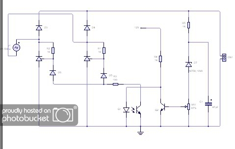

this works ;)
the battery needs to be above 8.5v to make the reg work, the 9v supply (can be 12v battery voltage )should be switched to the battery as there is a 30ma constant drain
the pot is a 1k trimmer that you set to 14.4v output accross the battery at max rpm. you may want to put a 45v varistor accross both scr's main leads to kill any nasty spikes

Cheers Spankey, I'm also work in a racing enviroment (F1)and know the way things don't want to live or work in a supposedly simple situation. Nice to have a proven design.
