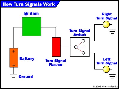

In the standard vehicle indicator light system there is no signal sent from the indicator switch to the indicator relay(flasher unit).
The switch is connected after the flasher unit and simply connects the flasher unit output to the left or right indicator lights, depending on which way the switch is moved.
See this very basic diagram.

Yes Kiwi, you are right.
I just had a good read up on the 12v vehicle wiring.
The relay has constant power supplied.
I thought that the relay was powered from a switch and could be tapped from there.
Martin.

My car must have double pole switches on the indicator control then... (it has cornering lights)
edit: More likely perhaps is that it has the indicator switch on the ground side of the indicator lamps, but I don't have a manual to confirm that and I'm not pulling things apart to find out :-D

The diagram I posted above is a very basic system.
There have been all sorts of variations to the indicator system, eg using the rear orange indicator lights as reverse lights, using the rear red indicator lights as brake lights(USA), sequential rear indicator lights(Ford Mustang).
Steve, your car could have a double contact switch, or it may have a module to control all the lighting. Some of the latest cars have very complicated computer controlled systems with several modules spread throughout the car.
Howard, the cornering lights only work in the direction you are turning when the headlights are on.
