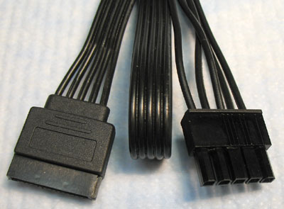

What I am using the cable for is to distribute power in my computer. it would be no more than 12v and the standard is 18 AWG wire. the motherboard connector is a 24pin plug and most others are 4-8 conductor.
Having dealt with routing ATA flat ribbon cables before the day of SATA I am well aware of the techniques to turn corners, however If i use individual wires as was suggested i can avoid folding the cable which would be more difficult with 18AWG cable as opposed to the 28AWG of data ribbon cable.
as for manufacturers, I haven't found anything that i would consider exactly what i want. there are several PSU manufacturers that use 4-6 conductor ribbon cable for their modular lines like this:
But finding the wire alone is proving very difficult.

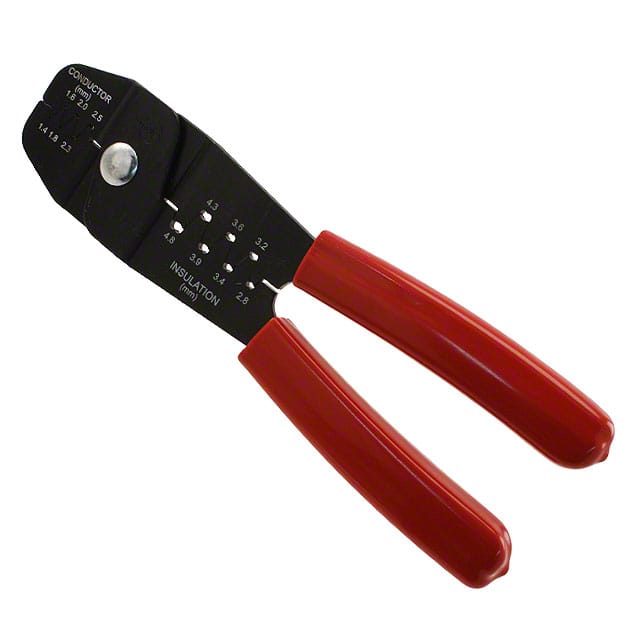

One other question, any suggestions for a cheap crimper than will handel Molex Mini fit Jr. crimp terminals?
CocaCola
Apr 7, 2012
3,635
Apr 7, 2012
3,635
I like many others have likely felt your pain after looking at the domestic offerings and OEM offerings on crimpers...
I went on a quest to find an cheaper alternative and came across the Engineer Inc. 'generic' crimpers out of Japan, IMO they are a VERY decent tool and they crimp damn good for a generic fit all type crimper.... I can do the factory looking/quality, double turn down crimps without any hassle now...
I link to this site only because it has a reference table...
http://store.iheartengineering.com/info/Crimper_Compatibility_Chart
From that it appears the PA-20 crimper might be up your alley, don't take my word for it verify the sizes and sorts with your own research, I only glanced at the datasheet for the connectors...
FYI there are some youtube videos of these crimpers in action
