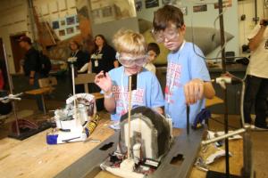

The Hovercraft competition appears to be aimed at demonstrating understanding and proficiency in basic physics. Below is a picture of a work-in-progress hovercraft. Note the metal "2x4s" used for the guide rails.
