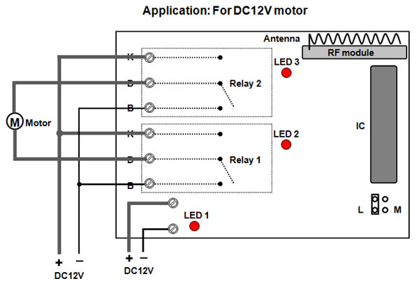

Hi all need simple help about wiring this alltogether, this three things:
1) dc motor
2) 2 ch remote contorl
3) two limit switch
I would like to click "A" for up and it stays on till first limit switch is reached. Then hit "B" for down till second limit is reached.
I already have connected dc motor to 2 ch remote control just like this, and it works great:
I
So i need to connect this two limit swiches somwhere on this wires, that is my qustion
I have limit swich like this
i would connect this switches, first one between "B" on 2 ch remote, one side on C., other side on N.C. and the second switch betveen K on 2 ch remote, same on C. and on N.C
BobK
Jan 5, 2010
7,682
Jan 5, 2010
7,682
You can connect both the limit switches in series with either of the power leads or the motor leads using the NC contacts. That way, if neither limit switch is activated the motor runs and if either is activated it does not.
Bob
vojotic
Apr 1, 2015
7
Apr 1, 2015
7
That means, if the one switch is activated motor stops, that is ok, the electric circle have no connection . but how to regain the electric circle... i must manualy release the limit switch..
maybe i am wrong
