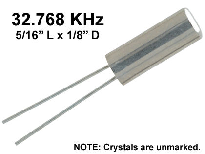

Hi,
I have noticed that a 32kHz crystal has malfunctioned i.e. not oscillating, it is cracked, what could cause this to happen?
Thanks

you sure you are looking at the crystal ?
most will be in a tiny metal tube with 2 wires out one end less common for them is like in the link that Bertus supplied
and occasionally will be in a epoxy type encapsulation like ......
So is it like one of those or something completely different ?
Also as Bertus said, it would only crack is physically struck. They only have a tiny current / voltage associated with them

Hello,
How did you test the crystal?
When it is a single crystal, you will need to make an oscillator with it.
In the attached PDFs you will find some oscillator schematics and other info for crystals.
