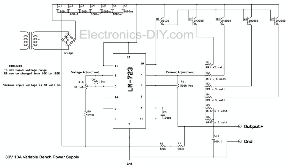

Hey, this is my first post here, so I need help with this circuit so I won't burn out my transformer or the parts, because they can be quite expensive for me :D
Here is the scheme
So I want to know if all those transistors would survive, the voltage control through R5 would work and current control through R6 would work. This circuit is based of this video
D1 is full bridge rectifier that converts AC to DC
C1/2/3 are for filtering
R1 is for discharging capacitors after the PSU is shut down
R2 limits the current through the zener diode
D2 sets the regulating voltage - I am unsure about that
R5 controls the voltage
D3 does something which I don't know what
R4 and R6 control the output current - Which I don't know if it works
R3 is for quick discharging of C4 after the voltage has been controled and C4 helps keep the output voltage at the level it is supposed to be
Tell me what to improve and what to fix so I can have working power supply. Thanks

Where to start? Probably by recommending you don't build it and try a more efficient way of doing it!
What do you need such a supply for? Is your requirement specifically for high voltage/high current? Sure you actually 'need' this design?
However....you should have some balancing resistors in the emitter of the pass transistors to equalise volt drop across them - otherwise that's a pretty basic and very inefficient circuit that will require a sh1tload of heatsinking!
Have you looked at the data sheet for the BD912? It's power derating is abysmal - down to only 35W at a junction temperature of 100degC. Draw some heavy amps at low volts (say 5A at 12V) and the 'rest' of the volts/amps (about 35V at 5A or 175 watts of heat!) will be dissipated in those pass transistors. That's 45W per transistor........ not counting the junction-to-case and case-to-heatsink losses so you'll be cooking chickens on the heatsink!
Seriously? Reconsider.......

I do not see any current control. R6 and R4 control current through D3 but this is not dependent on the current being supplied. The normal way is to measure the voltage across a low value series resistor and shut down the output voltage when the current limit is reached.

It does not regulate the voltage much because it is missing an opamp as an error amplifier with feedback.
The base-emitter voltage of the transistors change as they heat and change with load current. The 39V zener diode's voltage changes as it warms up and also changes a little when its load current changes.
I agree that you and the output transistors will have 323W of heat to remove (not possible).
The current control is based on dangle-biasing/starving the output transistors. R6 and R4 control the current through D3 *and Q1*. As the output current increases, the Q2-Q5 base current requirement increases, increasing the voltage at the Q1 emitter. At some point that lifts the emitter of Q1, decreasing the total base current available.
The current control is very "soft". That is, the transition from a constant voltage output to a constant current output occurs over a relatively large range of output current. Also, the crossover point will drift a lot with temperature and component aging.

I agree with dorke. It is not a great, or even good circuit, but there is nothing explicitly wrong with it.
Note - any linear supply will have all of the thermal issues. Moving over 300 W of heat is entirely possible, but you will need at least 200 CFM of air flow.

This
or this
This is my last resort :D

The LM723 circuit will give much better voltage and current regulation than your original circuit. However, the 723 has a max operating voltage of 40 V.
The LM317 circuit has no current regulation. And, it has poor voltage regulation because it is not the circuit recommended on the LM317 datasheet. That circuit uses power PNP transistors, such as a 2N2955. There are many schematics on the internet that show how to add multiple PNP pass transistors to an LM317, but adding current regulation is difficult.

So the LM723 is the way to go? I have 5 2n3773 which can be used instead of 2n3055 and I just need the regulator and some resistors to complete the circuit. Thanks
