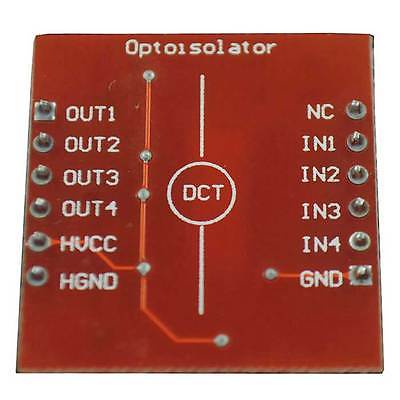

I have just purchased a 4 channel optoisolator but am unsure as to the pins - my research says NC doesn't do anything, is this correct? Also, I presume HVCC will be my voltage input line (I plan to use +5V) and HGND will be the ground. Does a separate ground need to be wired to GND on the right? Please see image below:
Much obliged for any help!

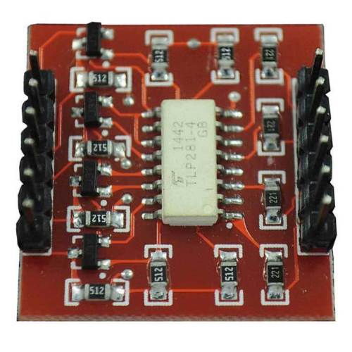

where's the opto ?
on the other side maybe ?
show us the other side
what opto is it ?

If you want the isolation benefits of optical isolation, then keep all left side and right side signals completely separate. Do not combine the grounds.

One thing, as I will only be using a single power supply, and will be using 5V to power both the Arduino and the load on the other side of optoisolator - so in theory they will be connected by ground anyway?

Note that in post #3, I said ***IF*** you want ground isolation, isolate the grounds (duh). Of course they can be connected, depending on the rest of the circuit requirements. Which are ... ?

Nice one thanks, haven't thought about this much, just running on the assumption that ground will be fine to share...basic idea is: Arduino feeds opto > opto turns PNP MOSFETS and NPN Transistors on > These power a Peltier array. All parts of the system are powered by a single PSU (PC PSU that delivers 400w of 3V, 5V and 12V)
In my ignorance ground isolation isn't really required, but who am I to say. Why would one want ground isolation? Can there be surges through ground that could damage it for example?

Cheers! I doubt its 'real' from a known manufacturer, and if it is the workmanship on the soldering isn't really up to scratch :(
I have no idea what you are talking about ???

Apologies. You linked to a Toshiba datasheet, I don't totally trust the supply chain this part is coming from
but that isn't related to Toshiba or their datasheet, aye ?

Correct, and I really appreciate the datasheet as it has helped. Just lightly commenting that whatever logo might be on it I don't trust it.

usually No Connection or on a relay ... Normally Closed
can you trace that pin ... does it have a pc track between it and somewhere else ?

On multi-layered circuit boards (and I presume this one only has 2 layers) this technique isn't always possible, correct? If yes would I have to resort to using a multimeter?

it may or may not be easily traceable.... hardest part will be where tracks disappear under the IC
