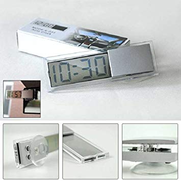

It is really difficult to explain but is it possible to make the last minute number (for example 15:36 the number 6 to be frozen forever) frozen forever? Clock would still work but it then makes a refresh after every 10 minutes.
Is it possible??
Thanks!

If you are asking about modifying a commercial product like the one pictured, that is would be very difficult to impossible, depending on the design. For a project built from scratch, easy.

Your question still is not clear at all and there are no details to use to form an answer. If you search for "digital clock schematic" you will find hundreds of schematics to choose from. To make any of them do what you want, do not connect the last display digit to the clock circuit. Instead, connect the segments directly to the power rails to form a zero.

Sir Yomastoz. . . . . .
How are things in Estonia !. . . .
Might I assume that you are needing time displayed in tenths of an hour . . . . like I spent 4.1 hours on this job at $50 per hour so my billed fee will be $205.
Also if your unit in question is indeed the ONE BEING SHOWN, it is using a transmissive family of LCD display . . . .because you can see the box profile behind it.
I have two of these types of small clocks and find out with certain colorations of backgrounds showing thru from behind them, in accordance to the place you are standing when viewing them, sometimes it makes taking a good reading difficult.
In both cases I have cut rectangular squares from white paper and bowed in to then snap in place behind the displays.
I now have no problem, with the initial frontal light reflecting back and giving me a uniform display at all times.
Thus being the equivalent of the other LCD display being made , of the reflective type.
If you are not FULLY knowledgeable in electronics and design savvy, let me fill you in on as to what is technically involved in creating that clocks display.
The display is composed of 4 display units arranged as HH COLON MM, in which case they can just blink the colon if desired.
They use 7 bars to make one display number, activating different bar combinations can create all of the numbers used.
Guess what ? . . .they call this a 7 segment display.
The building of the first clock using this type of display was using 4 individual number sections that consumed some amount of power, since they were either using low current incandescent lamps or LED's and a possibility of up to 24 segments being activated.
That's no big problem, if using AC line power for their power supply.
If you were wanting to build the same thing but using battery power THEN that WOULD be a problem, with the battery life /expectancy.
Then there is being fact that the human eye has a persistence of vision for a short period of time,so that came into play.
They used a principle called multiplexing wherein each of the four numbers being displayed is being sequentially activated, for just for a short fraction of display time.
This then means that the clocks info for the tens of hours, hours and the tens of minutes and the minutes is being updated and fed to all of the 4 displays.
Then the REAL power saving comes in with the sequential routing of power to ONLY one display at a time.
After a speed of 10 activations per second, any flickering effect gradually subsides, and the display seems to be constantly displaying those numbers,when they are sequentially displayed at fast speeds..
That is where the persistence of vision comes into play.
Soooooo that is what is being accomplished, and with modern technology its complexity + sizing can be reduced to a 2 mm sized chip, encapsulated under a black epoxy blob with hairline fine foil connections coming out to connect to the aforementioned 7 segments of each display number and the drive line that sequentially activates each of the four display numbers.
It just might be a trying task to work with that small of a unit get a constant O on display..
Not saying that I couldn't do it on my own unit, with a bright light, giant magnifier lens / or/ stereo microscope , micro soldering and some involved time.
My work around procedure would be to take that unit and place on a table outdoors for indirect bounce down sun lighting and find the optimal tilt for maximum contrast of display and get in for the closest possibility of a sharp photo.
Wait until the display comes up on 00 minutes and snap a digital photo, without flash, using indirect outdoor light without DIRECT sun on the display..
Print out the photo and use a machinist rule to compare the LCD size to the photos images digit size and you could use the one of the two zero digits that was captured, in case the first number had updated to 1
Print out the photo and use a machinist rule to compare the LCD size to the photos images digit size and compensate in the sizing of the next photo print out to create a 1:1 size ratio duplicate.
If you are using my mentioned white backdrop behind the LCD screen, just rubber cement the black 0 printed on a white background over the front of the existing fourth digit.
The fourth digit is then always covered and showing as a constant 0, with the tenths of an hour sequentially updating.
