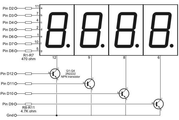

Hi guys! I am currently making huge 7 segment displays for our project. I am using 2 led strips for each segment. This is an outdoor project so I think I am gonna change the segments with multiple super bright LEDs. There is one problem guys the digits seem to be very dim when I try to switch it with the arduino. I've read that it is because the average current decreases as the number of digits being multiplexed increases. What should be an absolute remedy for this guys? Thanks!

Increase the average current.
if you want an average of 20mA in a 6 digit multiplexed display, the current needs to be 120mA.

But wouldn't that be very dangerous especially when the microcontroller stop switching (just in case)? I heard that it will also reduce the led's lifetime. What should be a safer remedy? Thanks for your reply by the way.

You could multiplex BCD to 7 seg latches and thereby drive the display statically. This will require 4 data for all digits plus 1 latch for each digit.. Show current schematic How many digits? .How much current and voltage per segment?

Although this is not really the same with my circuit, this concept of multiplexing is what I am currently using. Instead of sourcing current from the arduino, I am using a transistor instead.
By the way, could you elaborate more about what you meant by BCD to 7 seg latches. I know BCD to 7 Segment, but I don't know what you are talking about latching it. From what I've learned latch refers to a circuit which keeps the output on its set state regardless if you change the input. Unless you reset it, then it will change its state. So does that mean in order to display multiple digits you'll just have to latch it on the first digit, then the other digits? Which means all of them are on? Or are they still switching with each other? Thanks for your reply mate!

http://www.onsemi.com/pub/Collateral/MC14511B-D.PDF
For example. Connect all the data lines in parallel and the latch to separate pins. To change a display put the data on the parallel bus and toggle the latch pin for that digit. If you are using a bit of power you may need segment drivers. Info on display voltage/current per segment?
It certainly can.
If you're paranoid you can add a little magic to prevent the pulses going to the column drivers being longer than a certain time. This means if the uC freezes, the display will go out.
You can do this with a 40106 (for up to 6 columns) and a capacitor, resistor, and diode for each channel. You also need to invert the outputs for the column drivers with a simple circuit like this.

Each segment currently draws 12 V & about 100 mA. Does that mean if I have 6 digits, I need 6 BCD to 7 Segment Decoder/Latch?

Hehehe. We are currently making this for a government project that is why I am afraid of risking it. Anyway, if there is a way to keep it safe using such method then I would really be interested in it. I would definitely appreciate it if you could enlighten me. By the way, what do you call such circuit so that I could also research more about it. Thanks!
Thanks for all your replies.
Yes and a ULN2003 to drive the segments.

Sorry about the delay. This circuit will do the trick of preventing a problem if your uC locks up while multiplexing.
Note that this circuit inverts the logic signal.
As the input transitions from low to high, Diode D1 conducts and the output goes low immediately, and stays low.
As the input transitions from high to low, the output goes high immediate, but only remains high until R1 charges C1 enough that the output goes low again.
The RC delay should be longer than your normal column interval, perhaps by an order of magnitude. Try to keep C1 small (0.1uF is probably a sensible upper limit).
This circuit will introduce a slight delay (as well as the inversion of the signal) so you will need to allow for this in the programming of the uC to both get the correct display and to avoid ghosting.
If you need to limit the time the output is low (instead of high as in this circuit) connect the resistor between the input of U1 and ground, and reverse the diode.
U1 is 1/6 40106 or similar. D1 is any small signal diode (e.g. 1N4148).
Yes. See @GPG reply in post #16.
6 digits is far too many for an outdoor display
Only if the digits are multiplexed. If segments are driven from latches and illuminated continuously, any number of digits can be accommodated. Check out the countdown clock that NASA used to display (to the public) the time to lift-off of the space shuttle.
