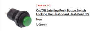

ah guys thank you. so remove that 1 push button on the pcb - and wire in 4 parallel. no idea but will do some research.
do i need more than 2 connectors on the bottom of the switches? im seeing some switches with 6!!! - i wanted to get something like the attached pic - but only has 2 connectors - this ok or 3 required?
