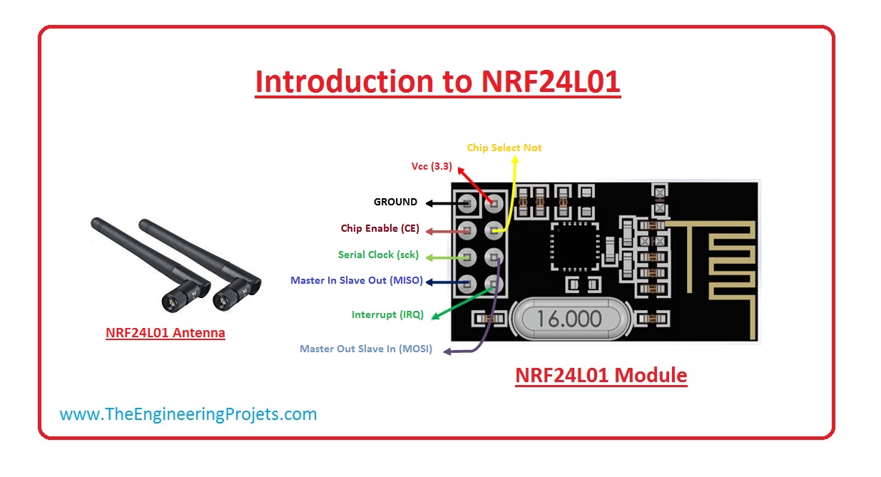

I think it's more convenient to get a new pair of 433MHz RF transmitter and receiver pair. Like the FS1000A.
By the way, if you ever consider using something more advanced, you can consider nrf modules.
In the datasheet of the product you mentioned, it gives a range of 200 meters, but unfortunately this is not enough. I think I found out what the transistor is, I want to try again by replacing it, this is probably the faulty product.. thanks for your attention ️
