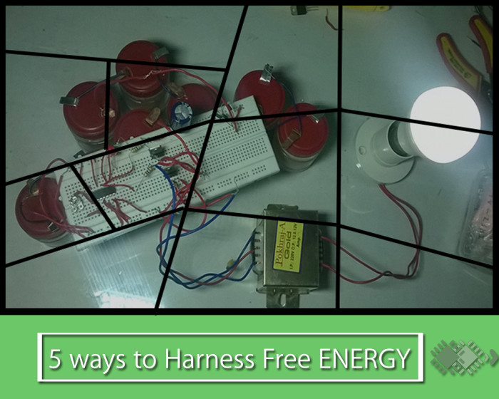

Hello, I was just helping my friend to create this inverter circuit to store free energy, generated from the solution of bleaching powder, and hence use it to light up a bulb. Here is a guide that might help you:
http://www.techlegends.in/5-ways-to-harness-free-energy/
Could use some suggestions to try new things with this setup

What a COS the link points to. The author claims "Each cell will produce about 1.3 to 1.8 volts depending in the concentration of bleaching powder in the cell. The current flowing will be about 300mA to 600mA in each cell." Then he goes on to say this: "Hence, 10 such cells in series will give you about 13-18 volts and the current will be about 3-6 ampere." Okay, I get that ten cells in series maybe produces 13 to 18 volts, but how do ten cells in series produce 3 to 6 amperes of current when each cell individually produces only 300 mA to 600 mA of current? Clearly that isn't going to happen. Nor are aluminum, copper, and calcium hypochlorite "free" for the taking at your local hardware store.
The only "free" energy is sunshine, which over the long haul makes fossil fuels if we don't kill off all the plant and animal life first.
