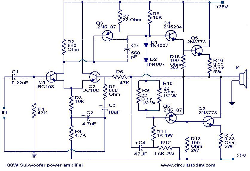

Am looking for an amplifier with 50w rms output into 8 ohm load (speaker).. Which IC is suitable for this project.. Am using single dc power supply..
Please help me with necessary details (circuit diagram)...

When you are designing an audio amplifier, specifying a single dc power supply severely limits your circuit design options. The sub-woofer is accepting low-frequency alternating current audio signals and producing sound by moving a voice-coil back and forth about a centered position in an axial magnetic field. The centered position occurs when no signal is applied to the sub-woofer.
To produce 50 watts into an 8 ohm impedance requires a 20 volt (rms) AC voltage across the speaker terminals. That's about 28 volts peak amplitude on either side of zero, or about 56.6 volts peak-to-peak. To get this from a single power supply will (1) require about 60 volts DC and (2) an electrolytic capacitor coupling between the amplifier output and the sub-woofer speaker terminals connected between the amplifier output and power supply common.
The amplifier output from a single 60 VDC supply will be at about 30 VDC with respect to power supply common when the audio input signal is zero. If you apply this DC voltage to the sub-woofer voice coil, it will either cause draw excessive current and burn up, or the voltage will cause the voice coil to move far away from it's normally centered position and create distortion and clipping of the audio sound output. Hence the need for the dc-blocking/ac-coupling electrolytic capacitor.
You could avoid item (2) by using bi-polar ±30 VDC supplies, or a slightly greater pair of opposite voltages, say ±35 VDC. See schematic below. You cannot avoid item (1) if you need to provide 50 watts into an 8 ohm load.
The reactance of the electrolytic dc-blocking/ac-coupling capacitor should be small compared to the 8 ohm speaker impedance, say 0.8 ohms at the lowest frequency of interest, but 0.08 ohms would be even better. Ideally, the dc-blocking capacitor would have zero ac-coupling reactance, but that is impossible.
If the sub-woofer response goes down to, say, 10 Hz then XC = 1/(2πFC) = 0.08 yields a value for C = 1/[2π(10)(0.08)] = 0.1989 F = 198,900 μF or about 200,000 μF. Good luck finding, or being able to afford, one of those puppies with a voltage rating of 100 WVDC or thereabouts.
Even if you allow for a capacitive reactance of "only" 0.8 ohms instead of 0.08 ohms, that still requires a humongous 20,000 μF electrolytic capacitor. And all because you refuse to consider using a bi-polar power supply to power your sub-woofer amplifier. OTOH, if you change your mind, maybe you could try building this circuit:
Also, maybe you could learn a little more electronics before imposing arbitrary limits on your circuit designs. Having a single power supply is a WANT, but there is good reason to believe it is NOT a NEED for this application and causes needless extra expense.

No problem with the design philosophy though there are some improvements that could be made but, this particular version would not be very reliable as the BC108 input transistors are only rated at 25V and on a ±35V supply would have 35V across them causing them to fail. Replacing them with KSC1458's which are rated at 100V.

Do not try making an audio amplifier posted on a website (Circuits Today) in India that uses antique BC108 transistors that have a supply voltage that is much too high for them. I did not check if all the other transistors will work in that old circuit and if they are also antique. The value of R2 appears to be too low so that the differential amplifier has loss instead of gain.
I used BC108 transistors when I was in University in Canada 54 years ago. I have never been to India.
Look in Google for 50W Audio Amplifier Circuit and most are on websites in India with errors and using antique parts.

The value of R2 in the power amp above is about right. This because: at a supply of ± 35V, the tail resistors of Q1 and Q2 set the collector currents of Q1 and Q2 at about 1mA. The voltage drop across R2 with 1mA passing through it is 680mV which is just enough to turn on Q3 taking into account R7.
As an aside, the output stage biasing comprising D1, D2 and R9, R10 is less than ideal as it takes no account of Vbe variations in the output transistors.

The amplifier circuit was probably designed on a simulator where "typical" Vbe spec's are used without having an adjustment for minimum to maximum variations in the diodes. The simulation software ignores over-voltage and over-heating of the BC108 transistors and maybe the other transistors.

I'm sure you are right or the designer did not understand the implications of what he was doing.
Websites "over there" have many circuits designed wrong. Maybe they use trial and error with many errors until it suddenly works"?
Maybe good luck allows a circuit using parts that were selected at random instead of researched and of designing using the range of spec's? Maybe one circuit was made and it happened to work but the parts were thrown together without using a detailed design then that circuit probably will not work if parts have normal lower or higher spec's.
