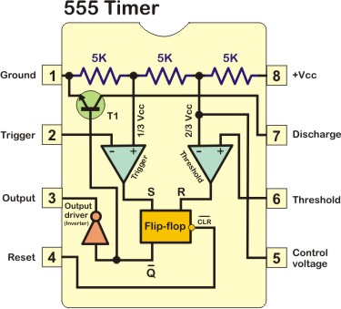

Pin 7 of a 555 is not internally grounded. It actively goes to ground to discharge the timing capacitor when the output pin3 goes low.try it without attaching pin7, its internally grounded. Just going from what I read at talking electronics
maybe thats his problem, no cap from pin 6 to 0v. I only see a transistor internally and pin 7 being the collector path. I don't see the path from pin 3. Do you know why his 555s are burning up?Pin 7 of a 555 is not internally grounded. It actively goes to ground to discharge the timing capacitor when the output pin3 goes low.
equal mark space
Sorry, don't understand. Pin 7 is usually the internal controlled discharge path, so the capacitor will not discharge if not connected to pin 7.
