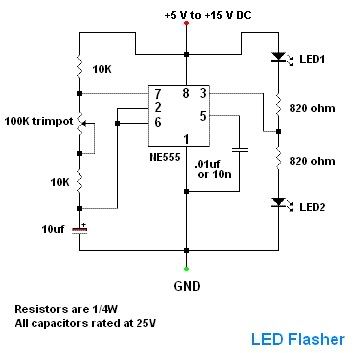

does anyone have 555IC led flasher circuits with atleast 2 LEDs? i had one but i guess i lost it.

The output of a 555 goes low and goes high.
So connect an LED in series with a current-limiting resistor from the positive supply to the output and it will light when the output goes low.
Then connect another LED in series with a current-limiting resistor from ground to the output and it will light when the output goes high.

just that simple, and why did'nt i think of that? that's cause i do not know electronics, thanks

Vary 100K trimpot to adjust speed of flash etc...
