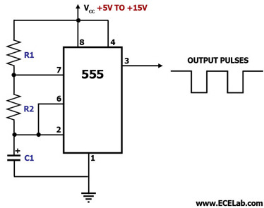

Ok, so I got all my parts in the mail for this, I got a few extras of each cause why not, and my pots are 200 instead of 250 k, but I figure that wont matter to much. But, in all honesty, I'm having trouble understanding what to hook where in respect to the 555 times since the pic is quite a bit blurry. Whats the best way to figure out how to lay down whats in the schematic on a breadboard?
This is the circuit that I am using by the way.
http://www.electronicecircuits.com/electronic-circuits/555-variable-frequency-square-wave-generator
EDIT: So I actually changed my plan and just decided to use this more simple circuit.

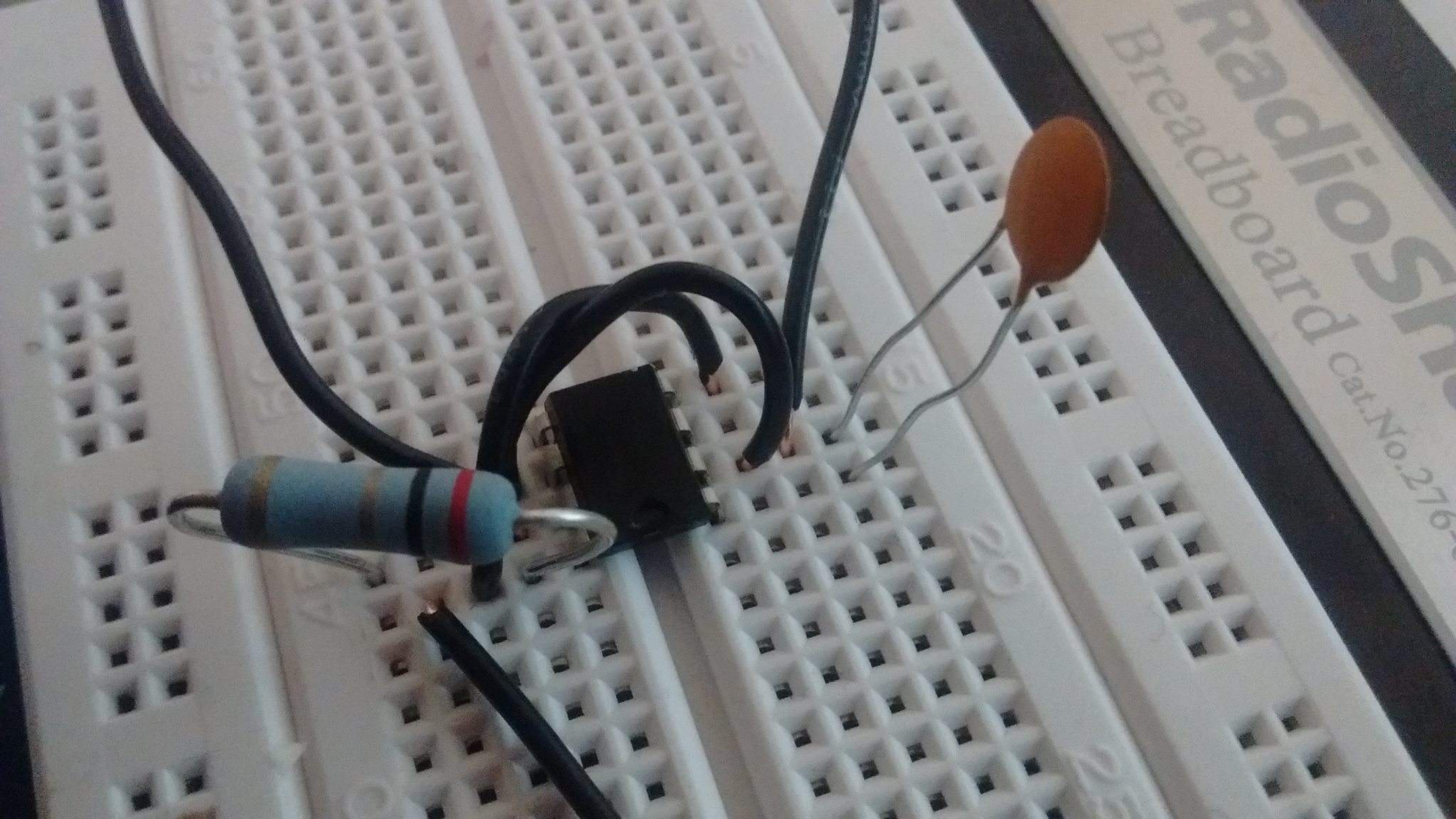

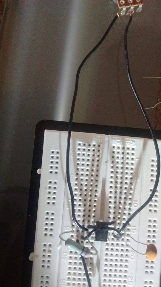

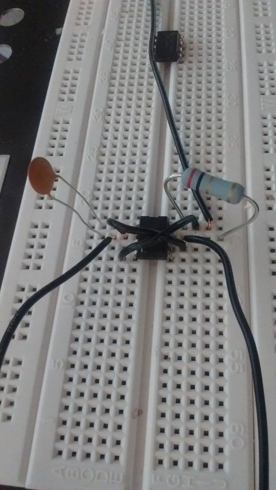

If it is even applicable to what I am trying to accomplish. So I wired it up, and here are some of the pics of what I have so far, I'm sure there are errors so please let me know.
The power is the line going to 8. And the ground is not in in these photos.
Basically is all I'm trying to do is produce a lower range frequency(square or sine), if they still made radio coils I would probably just use that and a capacitor lol.

What is the value of R1 (from pin 8 to pin 7)?
What is the value of the timing capacitor?
What are you using to look at the output? If you want an LED to blink slowly enough to be visible, the capacitor probably will have to be larger.

I see several mistakes....
I see only 1 resistor, you're missing 1, you also have a low ceramic value prob under 1uf, no problem though, with large enough resistance, also you made the curcuit difficult to build, use the rails at the top and bottom (if you have hookup wire)
Lastly although not an issue, you appear to be using 1/2watt resistors for a 1/4watt job :)

The other resistor is the two black wires going off to the pot in the middle pix.

Think you need to look a little closer at the operation of the 555 and what resistor and capacitor values values are recommended as minimum.
Talking Electronics have a good free online book on 555's and many circuits available with circuit explanations.
R1 looks like 20R to me but could be wrong.
Wiring twisted into a pot terminal like you have will cause intermittent operation.
A pot used in this way could at some time be turned down to zero, not a good idea.
If you must use a pot, use a minimum value resistor in series to avoid the problem.

My guess is that he order a 20 thinking everyone always knows it means 20K.
