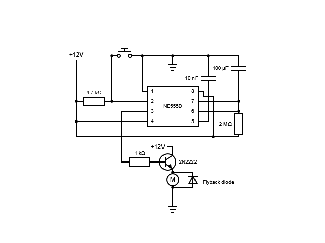

I would like to use a 555 timer to power a fan for ~4-5 minutes when a momentary switch is pressed. I read that the motor should have a flyback diode to protect the circuit - does it matter what the specification of the diode is or will anything work? I read that the 555 chip can source 200 mA and that should be enough for my small fan. Thanks for any help.

Almost any diode will work as long as it can withstand the 12 V reverse voltage and the current that is forced through it when conducting.
Use e.g. any of the 1N400x series. Even a 1n4148 will work here.
Regardless of the specs of the 555 I recommend using a transistor buffer stage as explained in our ressource for additional protection of the IC from possible voltage spikes or current surges from the motor.

Thanks. I added the transistor. Do you know whether value of the non-timing capacitor on 555 chip pin 5 matters much? I've read that 10 nF is appropriate and I happen to have one that seems to be 30 nF. I figure it's not critical, so long as it's at least 10 nF but I'm not certain.

Normally it's 0.1uF.
If you are working from a battery it probably won't matter much in the circuit you have there.
Try to keep circuit as a circuit drawing rather than "as built"...makes it difficult to follow, not so much for this but others may get more complex.
Also normally the transistor goes emitter/ground and collector to the motor with the other side of the motor to the 12v rail.

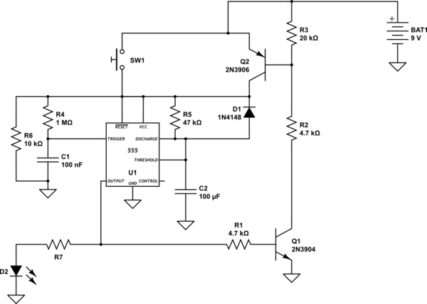

Thanks for your help. I've moved the transistor but I also have another problem in that the talkingelectronics website says the 555 timer chip uses 10 mA while running which means it will be draining the battery during the periods where the fan is off. I'm trying to figure out a way to make the 555 timer chip disconnect itself from the power when the delay runs out and is reconnected when the button is pressed.
I've found this circuit: https://electronics.stackexchange.c...ing-555-to-disconnect-itself-from-electricity which is supposed to do this but I can't figure out how to add those transistors to my own circuit because their switch is connecting reset and Vcc to positive while mine is connecting trigger to GND. Maybe I can use the same concept though if I also use the switch to connect pin 1 to GND (currently it's connected directly in my circuit).
Edit: no, I don't think it's possible to connect both GND and TRIG to ground via the same switch in such a way the GND remains connected to ground (through that PNP/NPN thing) and TRIG disconnects from ground when the button is released.

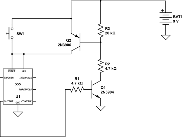

This is the final circuit offered on Stack Exchange. Do you think it wouldn't work? I'm still trying to get my head around it.
The button needs to provide power and activate the trigger at the same time.

Yes well, I'm no expert, plenty here are though.
From what you show in the link most say, won't work.
Why don't you simply use a cmos version of the 555..... ????
Have to be super carful with static until it's in circuit but.........
drag out a spec sheet and see.

The circuit in post #8 seems overly complex. I suggest going back to post #3, configure the output transistor as a saturated switch as in Q1 in post #6, with the fan in the collector to Vcc. With the CMOS 555, off-state energy is about 0.1 A-h per month at 12 V, less at 9 V.

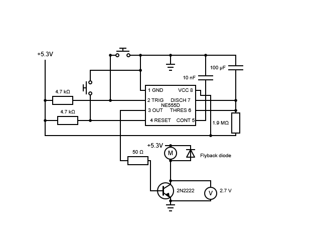

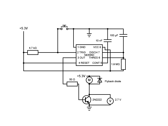

I switched to a supply of 5 V when I found a 5 V fan. The voltage coming out of the 555 output is 3.5 V and I figured a 300 ohm resistor would give at least 10 mA which should which at 40 hfe should give 400 mA. My fan only needs 180 mA but the voltage across the transistor is 2.7 V so the fan only has enough voltage to spin if I give it a flick. It's a 2N2222. I'll try maybe 150 ohms at the base instead but I really think 300 ohm should have been okay?
Changing to 150 ohms enabled the fan to start on its own but it's still only getting about half the voltage with the transistor taking 2.67 V across the collector and emitter.
I found this 555 timer at my local maker space with the intention of swapping it with a CMOS version when I got them but my multimeter says it is using <1 mA when the fan is idle.

Transistor is fine to use but as you've found, bit of fiddling to get it right.
If you simply use a 2n7000 mosfet, put a 220r resistor from pin 3 to the mosfet gate and a 10k from gate to ground. Motor goes Drain to positive rail and Source to ground.
Bump up the 555 supply to 6v and you should be ok.

I'm using a cheap module which takes the voltage of a lithium cell and increases it to 5.3 V (it's meant to be 5 V but 5.3 V is what it actually provides) since I have a few of them already. I'm not really happy that the 2N2222 Vce is 2.7 V even after reducing the value of the base resistor to 50 Ω but the fan spins for four minutes and the transistor does not get warm.
I would like to modify the circuit so I can cancel the timer and stop the fan. Should this be done with a momentary connection between reset and ground? Alternatively I could add a switch to change the voltage on the capacitor so it fills up faster, bypassing that 1.9 MΩ resistor?
