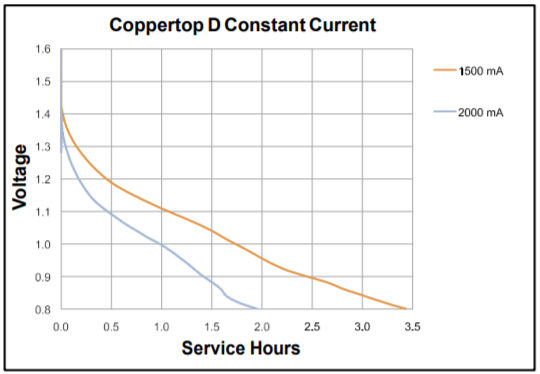

CircutScoper
Mar 29, 2022
300
Mar 29, 2022
300
The source is a normal 6-v battery. I would need 5.2V from it. 3A load is theoretical. I might get along with 1.5A.
Then even if it is a LARGE battery, you will likely NOT have a true 6V for input to the regulator -- at least not for long. For example, here's a typical discharge curve for an alkaline D cell. Note the immediate drop when the load is first applied.
main-qimg-b2be82a994828d342da316a7a59ce1ca
To see what reality holds in store for your battery, put a 4 Ohm (at least 10W) resistor across your battery and watch what happens with an accurate voltmeter.
CircutScoper
Mar 29, 2022
300
Mar 29, 2022
300
PS: Having no idea what you think a "normal 6V battery" might be, I used 1.5V alkaline D cells as an example of a fairly "large" battery. Their typical nominal amp-hour rating is ~15AH. But as you can see from the graph above, a 6V battery made from four of them connected in series would drop below 4 x 1.3V = 5.2V in just a (very) few minutes when connected to a 2A load.
