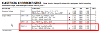

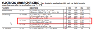

The specific hint is in the type numer: LT1117-3.3 - teh bold suffix indicates a 3.3 V regulator. The datasheet shows this clearly:
