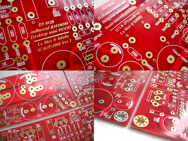

Yep, that would be the basics of it, you can get real creative with it if you play around... There is one layer not shown there, that would be the bare board with no resist, usually a pail translucent yellowish color...
attachment.php
On thing this does not show is layering these layers, say for example you put the gold pad text over slightly larger copper with resist, and then outlined it with silk... Something like this... I know all Arty Fartsy but for me it makes designing boards fun, even more when the client compliments you on how nice the board looks...

I seem to have created that effect by putting the same text on 2 layers, signal and solder mask diptrace has a 3d viewer.
That will result in a significantly raised white text, another option...
As I said all this stuff is just Artsy stuff, it's simply fun stuff to do not really a part of 'legit' pc board design...

I love all this fancy stuff I want my PCB to look like the one in that picture!
What do you mean significantly raised white text? I assume the mask layer is to cut out parts of the solder mask and the signal layer is to put copper there which would be gold with an immersion gold finish (looking at the pcb quote page on rushpcb.co.uk) I removed the text from the silk screen layer if that's what you were thinking, in the 3d viewer the text is the same colour as the pads round the thru holes it looks nice, I can give you a VRML file so you can see it in a VRML viewer if you like?
I misread, sorry I though you put the silk layer on top of a trace...
The board will be layered like this...
There is the PC board substrait aka the fiberglass board itself... There is a full coverage bonded layer of copper applied to this board... The board is 'etched' and copper is removed where it's not need, so you are back to bare board in these locations... Then there is a layer of resist applied to the board over everything except the pads, this can be an applied ink resist or a film resist (depends on the manufacture)... Then there is a layer of raised silk screened ink printed on top of everything... And last but no least any exposed pads are plated... All these layers are significant enough that they create ups and downs...
And last but not least the end results will vary slightly from manufacture to manufacture and from what the 3d render looks like... Once you establish a relationship with a board house you will get a better idea of what the final boards will look like... Some of the things that really vary is the translucency of the resist... From some board houses it's so opaque you sometimes have a hard time seeing the traces, from other houses it's drastic... There is also a world of difference in silk screens... Some companies are crisp and clear with high details, others have real soft details... Also some silks are really raised others hardly at all...
