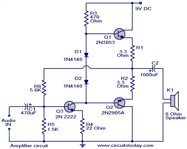

Yeah I've been all over the internet. I've got the preamp figured out but I'm not sure what comes next. I'm using a common emitter for the pre part but... Should I use push/pull for the second stage? Is it possible to create a circuit that can drive an 8Ω speaker similar to a Smokey w/out having to use a 386 chip?

I've seen this circuit a hundred times. It's a push pull, yes?

Most speakers are 8 ohms.
The most important spec for a power amplifier is, um, maybe its output power?? The amount of output power at clipping tells you the power supply voltage that is needed.
You mentioned an LM386 that produces 0.45W at clipping into an 8 ohm speaker when the battery is brand new 9.0V. Then the peak current is 5.4V/8 ohms= 675mA. Little transistors have a maximum allowed current too low so a little power transistor like TIP31 and TIP32 must be used at the output. Their minimum current gain at 675mA is about 35 then their peak base current is 675mA/35= 19.3mA for the driver transistor to produce.
Here is a very simple 0.45W power amplifier. Use Ohm's Law to calculate its resistor values. Look up "bootstrapping" in Google.
that's the same circuit I posted up the page, just a variation in transistor types

A simple circuit is the same when it is copied. Its sound and performance are awful. But some people like a guitar amp to sound awful and have terrible performance.
I was wrong about the peak voltage. The peak current is half of 675mA which is 338mA and the peak driver transistor current is only 7.5mA.

In my feeble mind, those two diodes will only cause more resistance, and reduce amplification, I would lose them. Then I would take that tripple threat deal back to the egg..I would loop it back through the system 6 times before reaching cascade amperage, then dump the new amplified current straight out the output without a cap to stumble over.
0 for 2. First, they do *not* "cause more resistance". Second, if they did, that resistance would be in the voltage amplifier collector and *increase* the "amplification". Do you know why the diodes are in the circuit?
