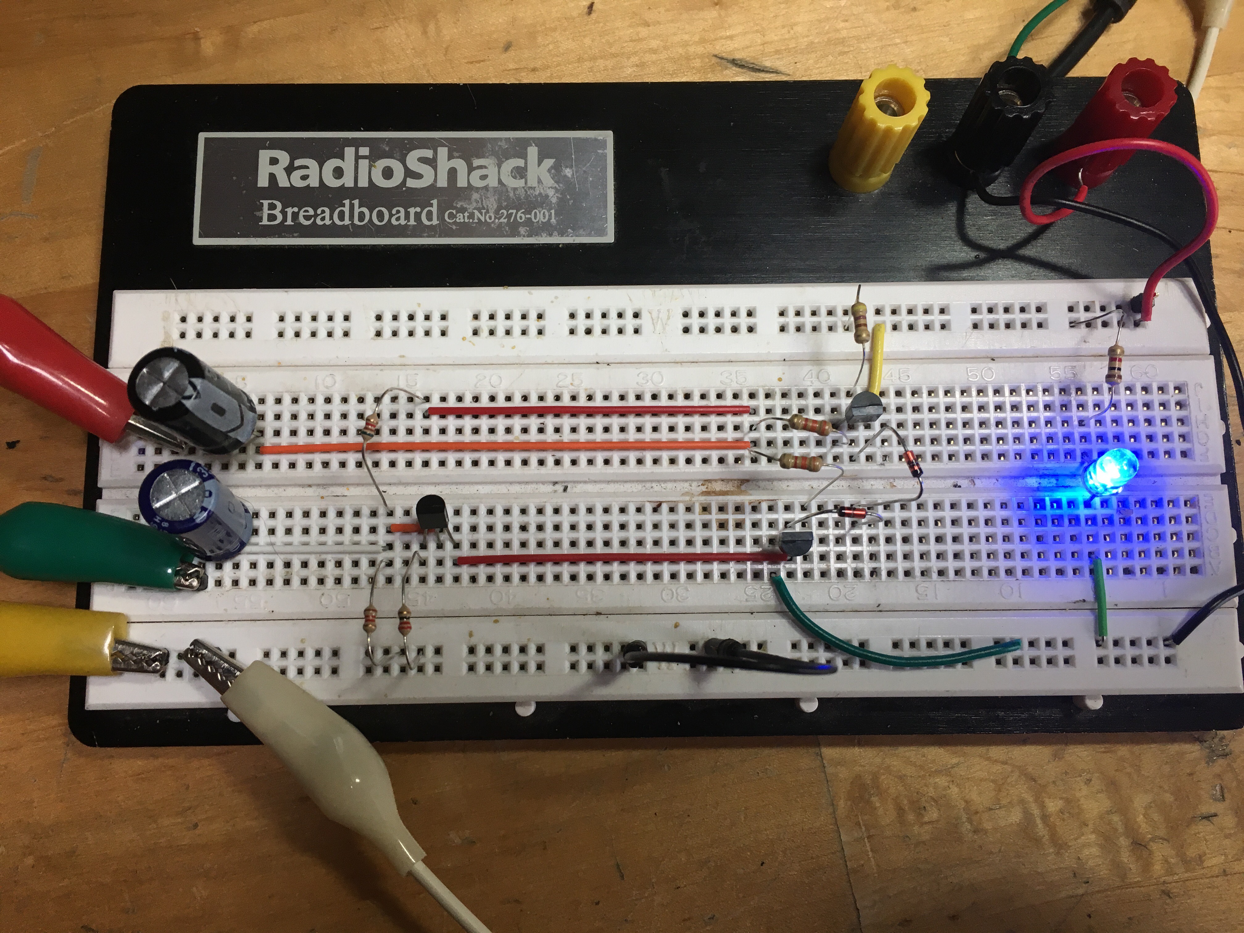

Hi again, quick update before the weekend sets in.
I've completed REF C with the exception that R5 is 1K (waiting for 1.5 in the mail) . I'm not sure why but it's not outputting at all. I've been digging into and going over it for a few hours with no success. I'm sure it's something silly. I'll start probing it tomorrow morning with my new scope (yay!) I'm very optimistic and will be spending the rest of the evening gormandizing education content on youtube. I'll check back in this weekend with my progress. As always, thanks guys!
EDIT: The input leads look backwards but they are connected correctly.
Audioguru
Sep 24, 2016
3,656
Sep 24, 2016
3,656
The loudness is low because the maximum power in the speaker is puny, about 0.25W like a cheap clock radio.
It will be a little louder if the output transistors are replaced and the supply voltage is increased. The 3.3 ohm values of the emitter resistors for the output transistors are much too high and are throwing away almost half of the puny output power. Bootstrapping would increase the gain and the maximum output power.
When R5 is 1k then the voltage divider of 100k and the 1k produces a base voltage for Q3 of almost nothing which turns it off. 1.5k will also turn it off. If you want to use an R5 then a reduced value of the 100k resistor must be re-calculated (maybe 8.2k when R5 is 1.5k) which will reduce the amplifier sensitivity a lot.
The new schematic shows two R1's and two R2's which causes confusion.

Sir Don Perry . . .
Your last breadboard rebuild fault shown here, seems to be the use of 33 ohms ( Orange-Orange-Black + Gold + 5% tolerance) for RE1 and RE2 emitter resistors, now resulting in current availability being even worse than AG’s comment.
IF eventually being used, up the wattage ratings from the presently shown units.
If you want to proceed forward NOW and ride bareback instead of with a saddle.
Just try omitting the emitter resistors as you did before. No problem in using two series 1K in place of R5 to then see if the overall performance / voicing result is being better for you with or totally without R5.
Then, wiring in the additional frontal preamp xstr circuitry will see if your slight extra volume need is then met .
