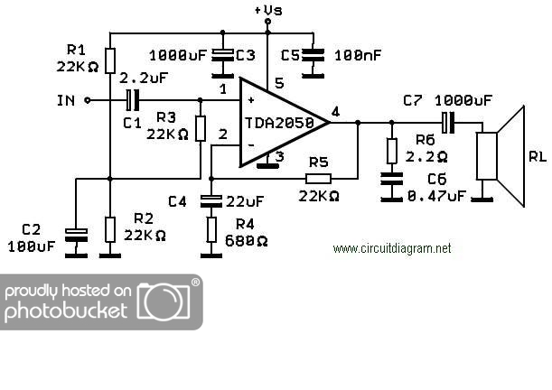

OK something else I have noticed, after reading the data sheet for that IC, I have no idea why the creator of your circuit has +12V going to Pin 2 of the IC via that 18k resistor. That just doesnt seem right.

Davenn was right. There's no 18K resistor on input pin2 of IC.

@Davenn, I grounded every part needed to be grounded from the start. We're good there.
@Rleo, So you think I should try removing the 18k ohm resistor all together?
I was thinking that the output (pin 4) should go to the string of LED's to power them. I'm not sure though. I've never worked with the TDA2050.

Yes remove the 18K resistor as Davenn observed.
All LED’s were connected to +12V and TDA2050 pin4 only completes the circuit to ground every time the signal goes low voltage. That is, LED’s should not light if there’s no audio signal.

Update:
I have removed the 18k ohm resistor on pin 2 as Rleo and Davenn pointed out. Still, the LED's come on when I plug in the power adapter, and when I plugin my music sourc, the LED's aren't flashing.
The way I have the audio in set up right now is just
Code:
L ----------
              \_______
R ----------
Ground (goes to the common ground with everything else in my circuit.)
This is what you guys are suggesting, correct?;
Code:
   47ohm
L --/\/\/\---
              \_______
R --/\/\/\---
   47ohm

@Joshie: Yes, the second drawing is what everyone here is suggesting. We are not exactly agreeing on the value (47 ohms). You may want to experiment with that.
From looking at the circuit, it looks like the 18kohm resistor is adding some more bias from the +12 volt supply to the negative input of the amp. This may be needed in this circuit (or not).
It also looks like the lights should not turn on with no signal, but they should turn on when the input signal goes low. So, maybe the incoming signal needs to be bigger to switch the amp so that it will output a low signal and turn on the lights.
Anyone see this?

Guys, I am thinking maybe the circuit is wrong. I believe the 18kohm resistor should be in the circuit, but it should be going to ground (not +12). Here is why:
With no signal in, the dc voltages on the amp will be (approximately) 6 volts at pin 1 (+ input), and pin 4 at +12 volts will make pin 2 (- input) around + 5.4 volts (voltage divider 18k and 22k). C4 (22uf) is also being charged to the same 5.4 volts.
When a signal is applied and it's peak negative signal would need to drive the + pin down below 5.4 volts to switch the pin 4 output to a low output and turn the LEDs on.
When pin 4 goes low, we now have pin 2 tied to ground through both 18k and 22k resistors. C4 will keep pin 2 at 5.4 volts until it starts discharging through these two resistors. Once C4 is discharged enough to bring pin 2 below the voltage at pin 1 or the input signal goes high once again, then the pin 4 output will once again swing high and turn the LEDs off.
So, does anyone agree that maybe the 18k should be there? Only tied to ground?

@sid
I've tried basically everything. I have tried the 18k resistor to +12v.. I've tried it to ground also. Both leave the LED's permanently on, not flashing to music. I've also tried it with no 18k resistor at all, and when I plugged in my phone to play music, same thing; but when I took my phone off I couldn't control the volume any more, almost like it fried my volume control. I reset my phone though and all was good.
Sadly, $20.00 in and a few weeks of digging I might have to give up :'(

One think you should check.
Ensure there is no connection between the two 22k resistors and the input.
The lines cross on the circuit diagram, but they do not connect. If you've connected them, this may be why your phone is affected -- it shouldn't be.
