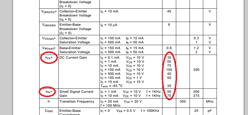

By the way, I have one last question. Uhm, how do you find out the minimum Beta for saturation. When I look at the datasheet there are a lot of values for Hfe. For example, the 2n2222a bjt has a lot of hfe values on its data sheet. Which one should I consider?
Thanks again!
