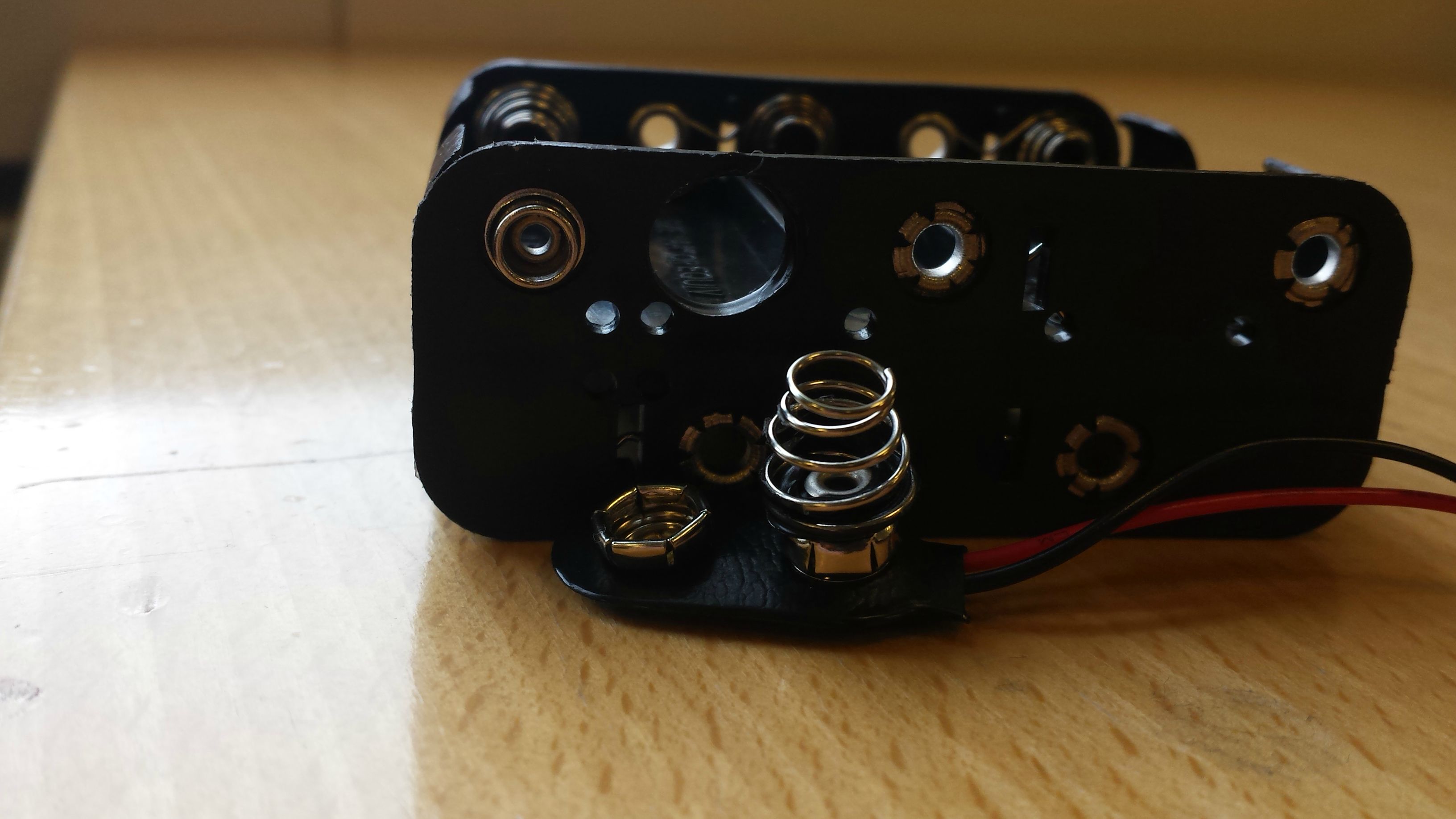

Trying to start the code yelded an "I/O Error" which certainly made sense since fire and brimstone spewed out of the batteries (okay just smoke, but a broken batterypack none the less) To our amazement, the battery socket had its negative pole melted CLEAN out!

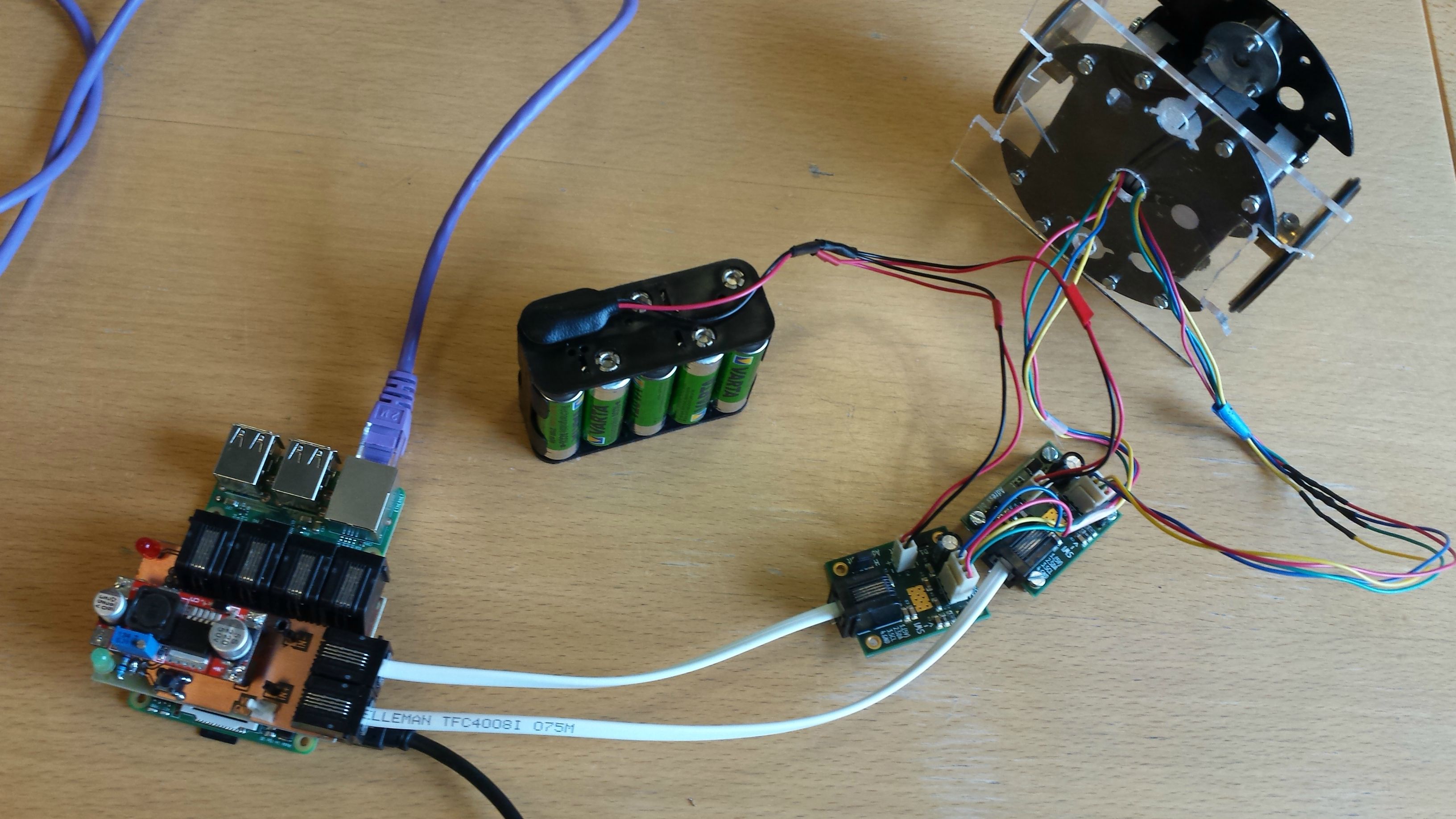

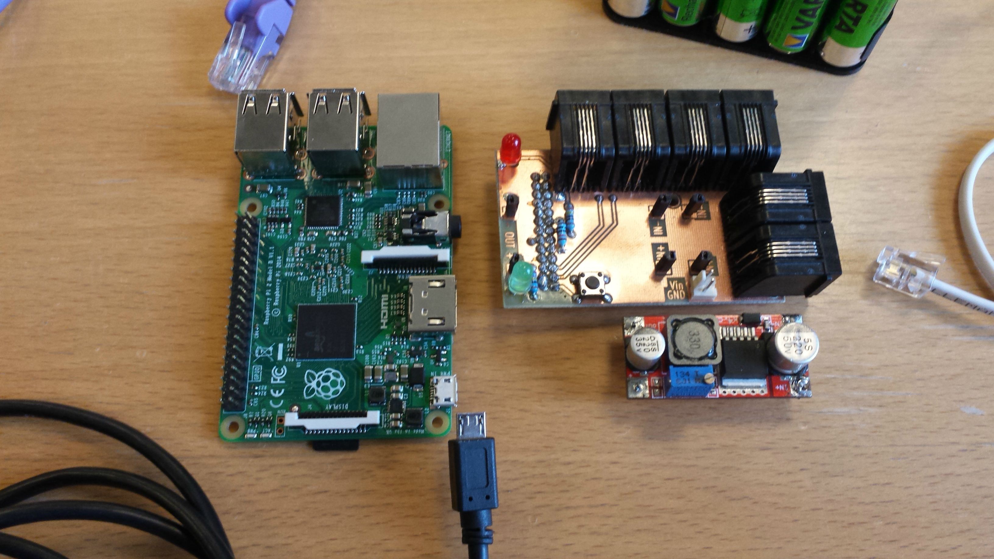

We got a new socket and retried connecting everything, but we still had the same "I/O Error" problem. So we started testing.. First off, a picture of our setup:

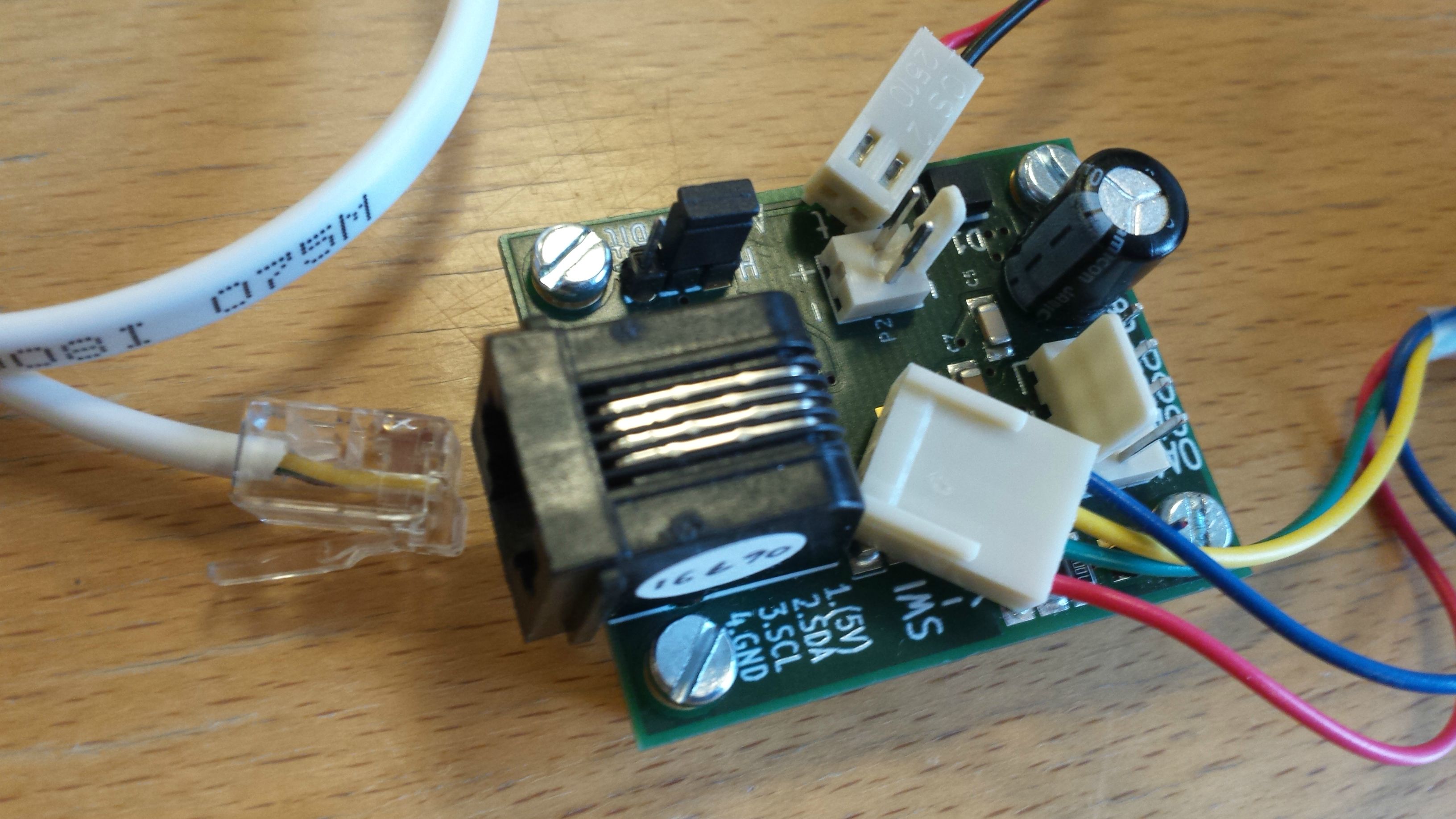

The Raspberry Pi runs a program that connects to a certain address though the I2C-bus and thus communicates with the TMC222 Motor Controller to command a wheel to turn around, all of which worked fine before. It is worth noting that we have a 50 page datasheet for the TMC222 available.

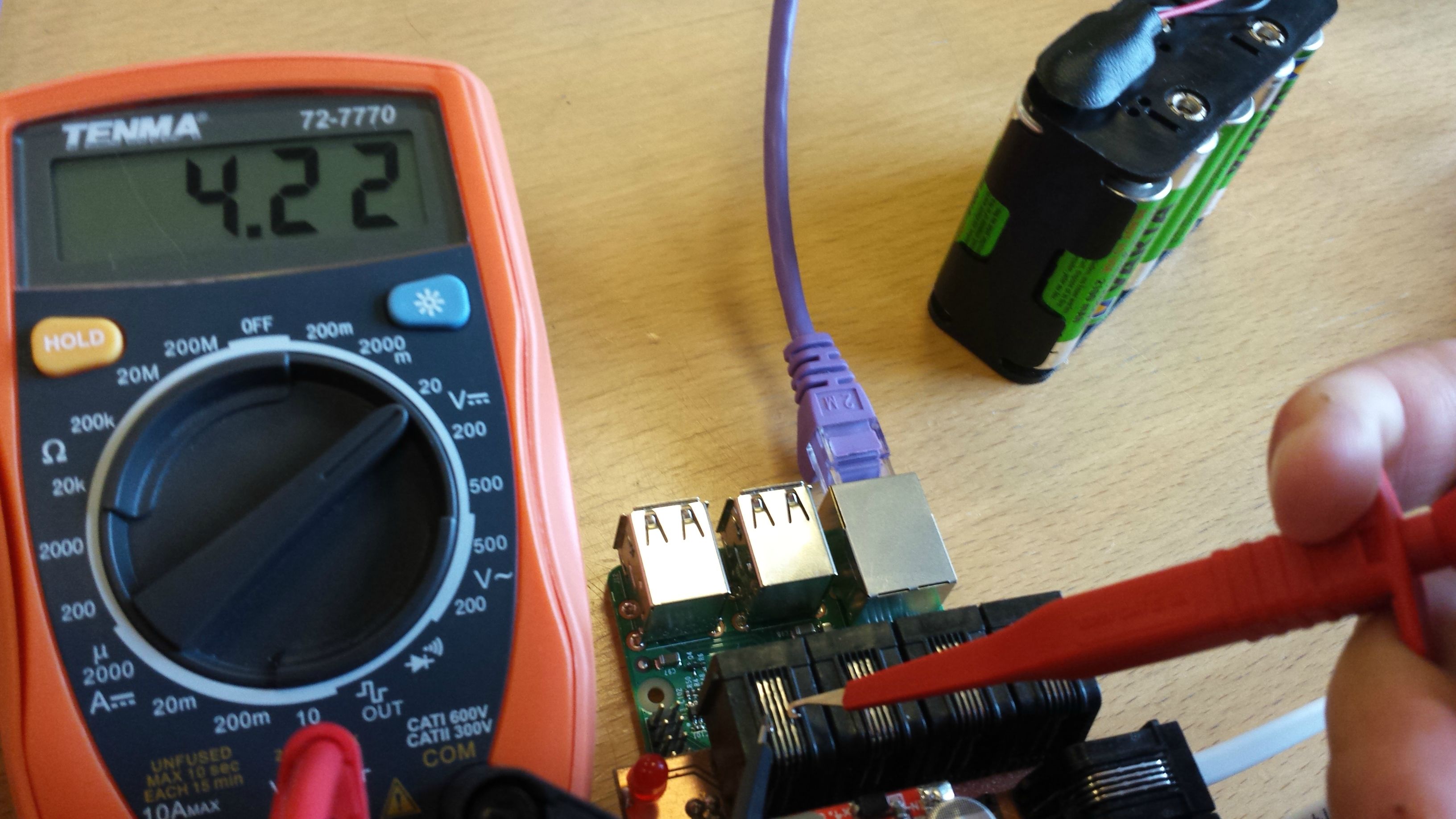

2. The daughter board when mounted on the Raspberry Pi and with the voltage divider on top seems to output the correct voltage value when we measued the voltage across all the outer wires on each of the 6 bus outputs, as shown here:
3. The voltage divider also gives off the same voltage value when measured directly

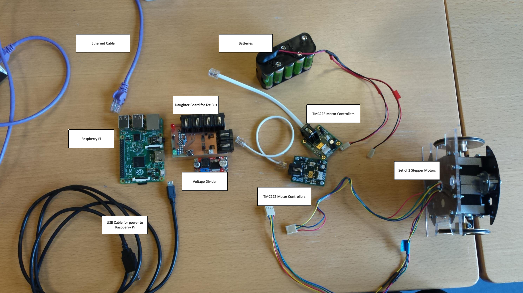

Here is some more pictures of which components we have:
Raspberry, daughter board and voltage divider:
TMC222 and the wires that connect to it:
All parts connected:
It should be noted that we are not supposed to make the cables ourselves. All our job is, is to figure out how to connect these components and what code to write on the Raspberry Pi. Please be gentle with your eletronic language, we are IT students after all.

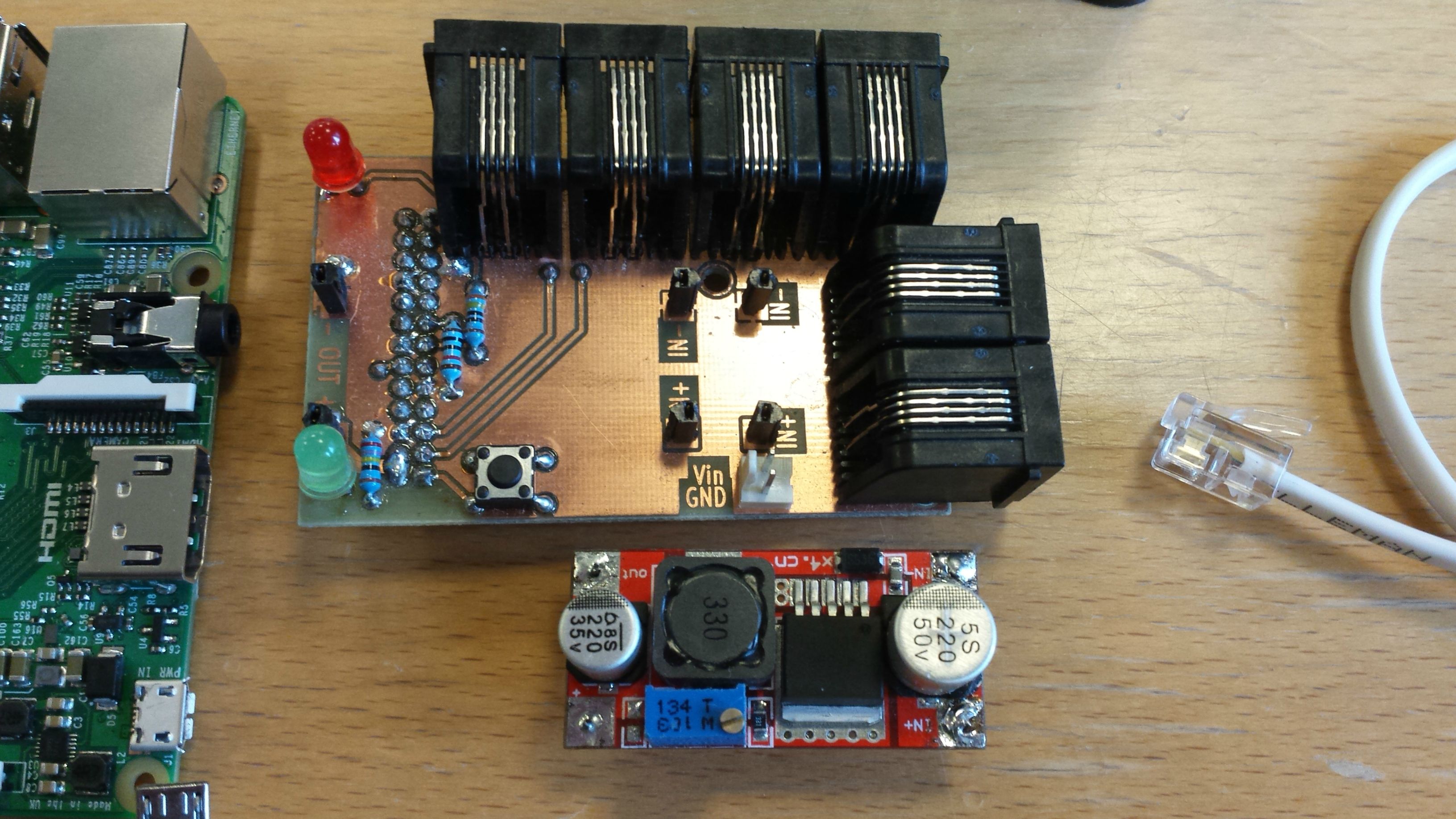

===> A "voltage divider"?
It is probably a step down DC to DC converter,any part number on it?

Update with the "partnumber":
Here is a closeup picture of the so called "step down DC to DC converter" (the little red device in the bottom):
There are no datasheet for this, and all the partnumbers we can see are the ones visible on this picture here. We just got it from our professor, and we even had to solder the pins for each corner onto it ourselves.

The "step down DC to DC converter" is indeed that.
look here:
http://www.ebay.com/itm/Super-LM259...749978?hash=item25a90950da:g:mKYAAOSw~gRVkqvx
Looks like you set it's voltage to 4.22v, why that voltage?
The board it is mounted on is probably an I2C spliter/level-shifter.
Have you got it's schematics?
Have you got the schematics of the TMC222 board itself,not only the IC on it?

The so called "I2C splitter" seems like it was made on site here at our university, im not sure the schematics is publicly available anywhere. Nevertheless, it barely has any components on it, 3 resistors, 2 diodes and a button.
We only have the schematics for the TMC222 chip unfortunately.
We attempted to set the voltage of the step down converter to 5v, but for some reason this changes once we run it, and weirly enough, turning the little screw does not change the voltage measured. It is not high priority, but we are wondering why it is like this. We probably COULD figure out what the status is for the old Raspberry Pi, but we are busy as it is, so we will not prioritize this.
