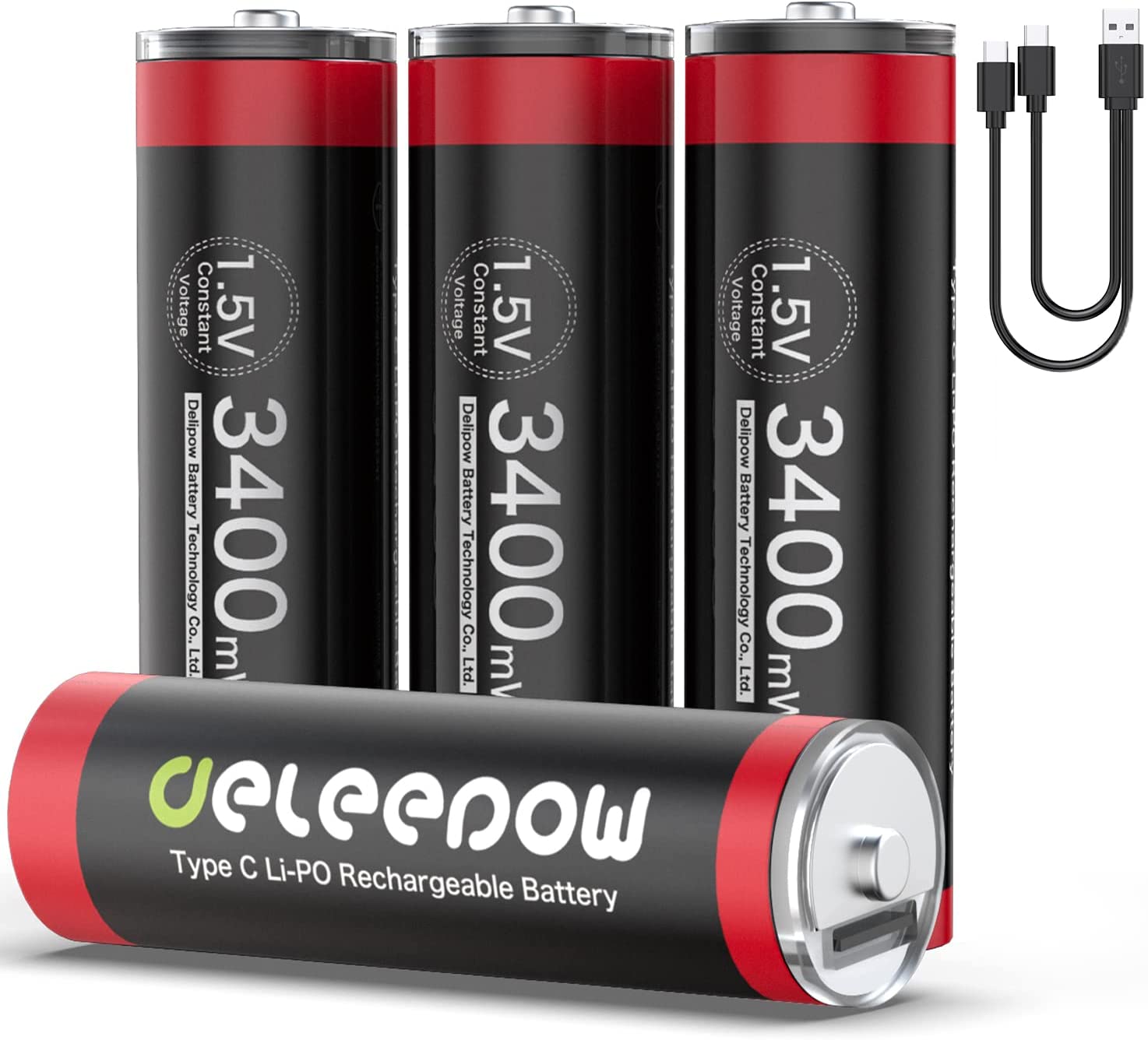

Other animal are AA Li ion cells with an internal regulator to output 1.5 each.
Another trick is to modify the device to use AA Li ion cells, by installing a voltage regulator at the battery holder/pack output to match the device requierements.
