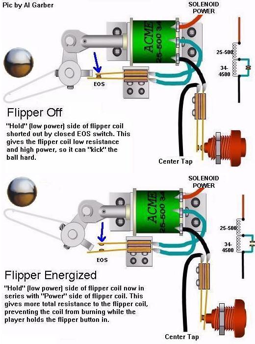

Thank you for all of your responses. I will be wiring the flippers according to the diagram below but can use some help deciphering everything. I understand that the EOS switch serves to prevent overheating of the coil by switching from "high (kick) power" to "low (hold) power". I'm confused on where the wires connect to however. I'm assuming "SOLENOID POWER" gets wired to the V+ of the converter I described in my earlier posts.
Where does "Center Tap" lead to/get connected to? Would this get connected to V-? Also, since I will be having two flippers and possibly more solenoids on the play field, would it make sense to divert the 28V power supply to separate circuits containing one solenoid each?
If the solenoid is designed to be operated from the full 28V DC, then yes, I would say so. But I have no experience with the innards of pinball machines. I don't know why that wire would be labelled "Center Tap". Centre tap of what?
I don't understand the question. The power supply needs to supply all of the solenoids, so each solenoid circuit (the complete circuit, including the two-coil solenoid, EOS switch if applicable, and user pushbutton) needs to be connected across the power supply. So these circuits end up being connected in parallel with each other. Whether you run the power supply output wires (+28V and 0V) around the machine and tap into them as required, or run a separate pair from each solenoid circuit back to the power supply output, is up to you.

It's also possible that a solenoid coil includes a diode in series with the connection, in which case reverse polarity will not activate the solenoid at all, and/or a diode in parallel with the coil, to eliminate inductive kickback (look at the pages you find through https://www.google.com/search?q=diode+inductive+kickback&tbm=isch) in which case reverse polarity will cause very high current flow and will probably damage the diode and/or power supply. In those cases, polarity should also be marked.
The flipper assembly I will be using http://www.pinballlife.com/index.php?p=product&id=172 does not include a diode in parallel with the coil, where as other coils on some machines includes this element. Would you suggest adding a diode to eliminate inductive kickback? If so what size sould be used for a coil running on 28V and drawing roughly 0.5A for hold current?
Right, thank you for simplifying that, sorry for the convoluted wording.:)

The diode needs to be rated for at least as much current as the solenoid draws. If the solenoid draws less than 1A, a 1N4001~4007 as Trevor suggests will be fine. As for whether to add on or not:
Without the diode, the inductive kickback will generate a high-voltage pulse which will cause arcing across the contacts of the switch when it tries to break the circuit (i.e. when the operator releases it). This will probably greatly reduce the lifespan of the switch.
With the diode, the switch will be protected, but the solenoid will not release as quickly as it would otherwise, because when the switch is released, the solenoid current will not fall to zero quickly; it will be maintained by the diode. The delay in the solenoid release will depend on the solenoid's inductance, mostly.
There are various compromises. As Trevor mentioned, you can put a resistor in series with the diode so the inductive kickback voltage is reduced but not to zero. You can use a zener diode instead of a resistor, which has the same effect.
I suggest you try just a diode, and if the delayed release is noticeable and has an effect on playability, we can consider our options. Another option is to drive the solenoid with a MOSFET (which is controlled by the swich) and use a diode with resistor or zener diode in series with it. This will protect the switch contacts while still giving a quick solenoid release.
