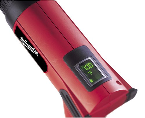

It's adjustable from 70°F to 1100°F. Yeah the airflow has 2 range settings, the low one works great, the high one is a little overblown, forgive the pun, heh.
That nozzle was just a 10 minute quickie, but it works pretty well.
Edit: I actually just had it apart tonight, the LCD temp display was missing half of it's digits, so I yanked it apart and found a few wires that had popped off the solder joints on the board. Problem's gone now! But anyways, I was thinking about adding a pot to the blower motor instead of just the 2 position switch to get infinite adjustability. Do you think it would be worth doing?
Here's a shot of the LCD panel, you can control temp to within 10 degrees. You move the slider on the handle and the display switches momentarily to "setting" mode, then after a few seconds of no movement it goes back into "reading" mode. It's got a closed circuit loop so it can adjust temperature on the fly to compensate for the different airflow settings.

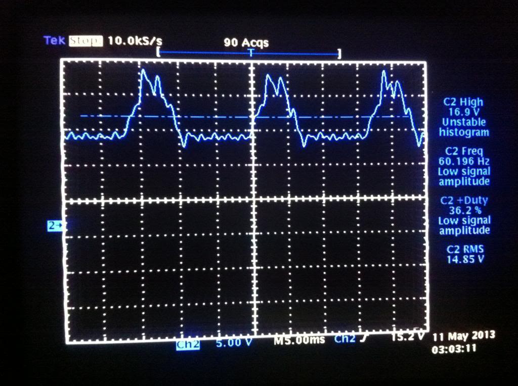

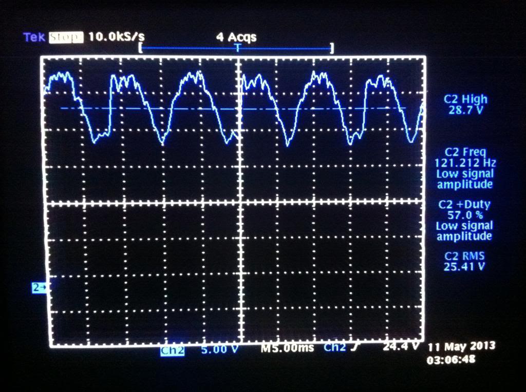

OK, new developments! Picked up my first oscilloscope and checked out the waveform to the motor. Here is what I discovered:
On motor low setting, I get a pulsed DC waveform that switches between 12 and 20VDC, with a frequency of 60Hz and a positive duty cycle of 30%. On high, it switches between 21 and 29VDC, with a frequency of 120Hz and positive duty cycle of 60%. So that's where it was picking up the AC signal.
So I guess it's either already running some type of switching circuit or I have heard of "chopping." Could it be doing that?

Sounds like it's running from half or full wave rectified AC.
You weren't using a 10x probe were you?
edit: a picture of the scope display would be very useful.

Ohh, you're right, I didn't think of that...the waveform shape is completely wrong for a switched supply. I just investigated inside the handle and there are several diodes under there. And yes, I was using a 10x probe, but it was compensated. This time I used a 1x probe to get these pics though:
Low setting:
image-4.jpg~original
High setting:
image-5.jpg~original
Was the only reason you asked about the probe to make sure the numbers were right? Or is there another reason that I should know about but don't since I'm a 'scope noob?
Now that I look a little closer, it seems that maybe the AC was just rectified on low, just passing through the tops of the AC waveforms, and on high, it is flipping the bottom waveforms of the AC up to the top. Sorry, I'm not really familiar with the proper terms yet. Would those be half and full-wave rectified?
