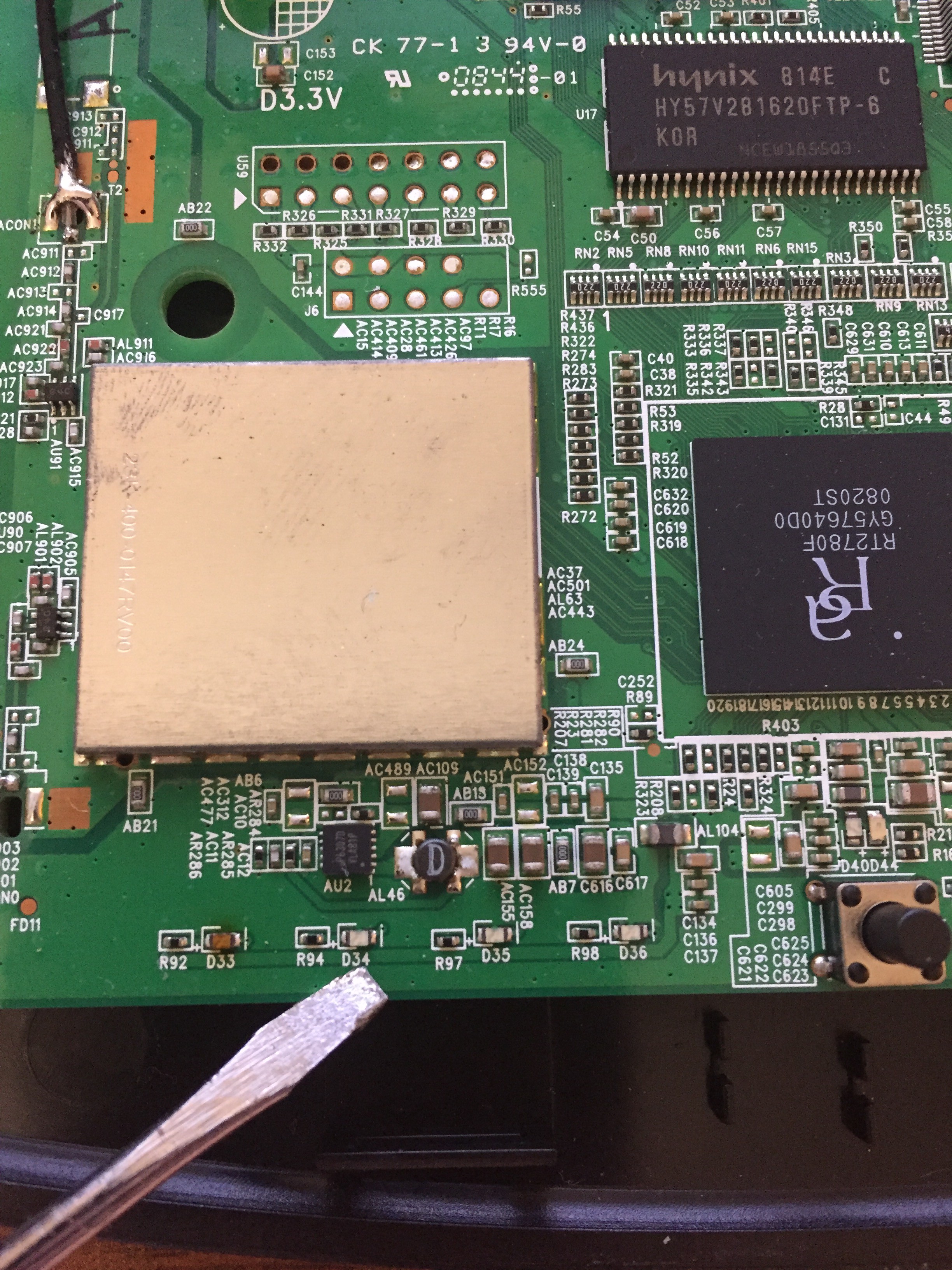

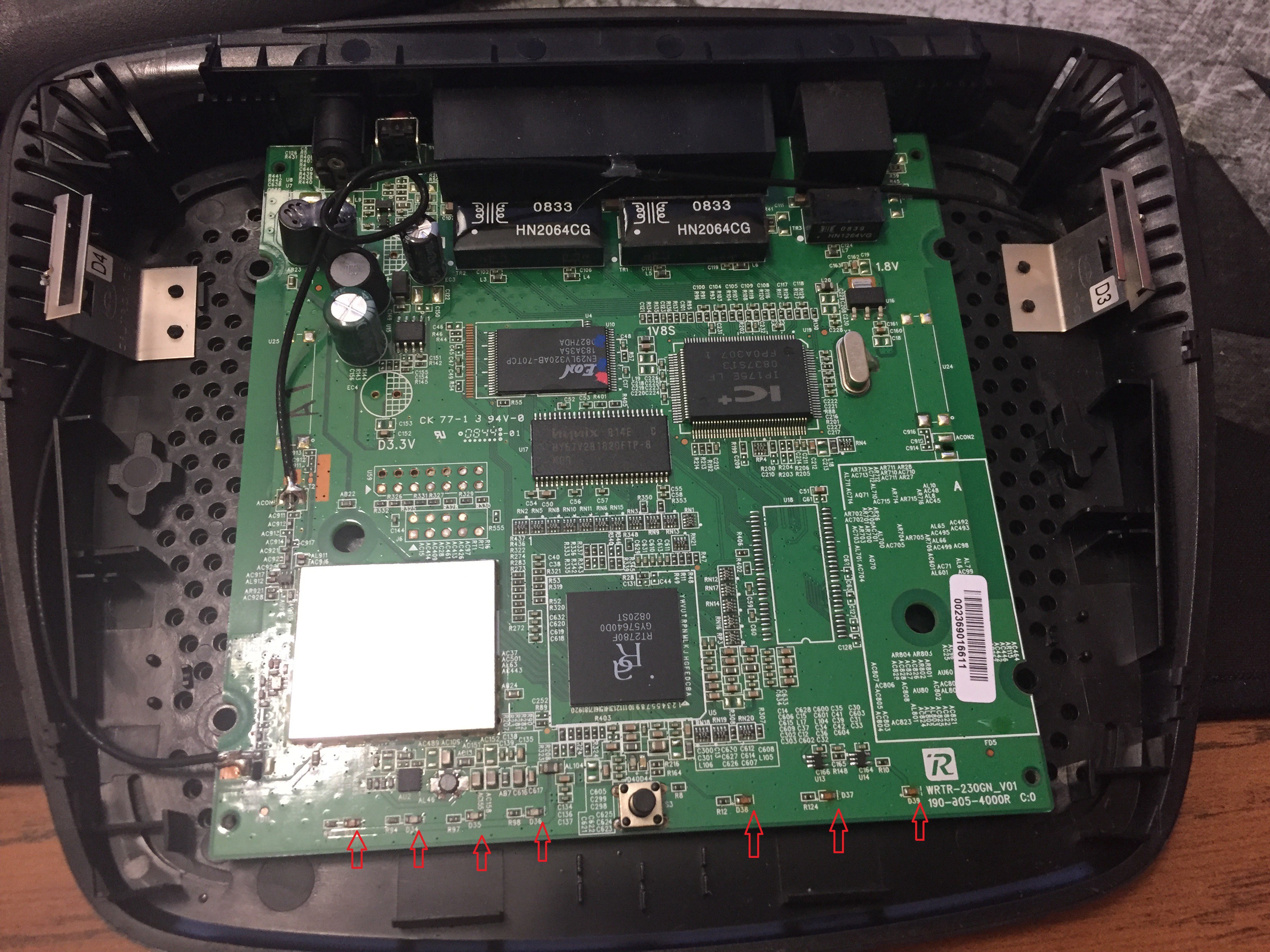

Hi all, total noob here!
Im looking at a project and would like to know how involved, if at all possible, to extend LEDs on a manufactured PCM.
Specifically a home router that has the LEDs directly on the PCB. I would like to add LEDs on a wire set so the LED would be emitting light away from the PCB.
What is needed?

Four of the LEDs would be lit if the there is a signal on the network jacks. Those I dont care about.
The ones I do care about are the wireless on, DSL, and power on.

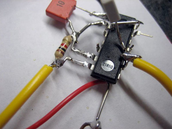

Also if you have ZERO pcb fabrication experience, since this is being a linear . . . in one side . . . out the other side, it might incorporate "dead bug" mount configuration of the IC.
In that situation, the IC is mounted legs up, on a small insulative board with a drop of super glue, and the leads splayed out, such that wire connections can then be made to them . . . . . such as is being seen at the two left leads in the foreground below.
ILLUSTRATION:
Then, you build up the mounting and wiring of the wire remoted LED's, as you wound have them.
