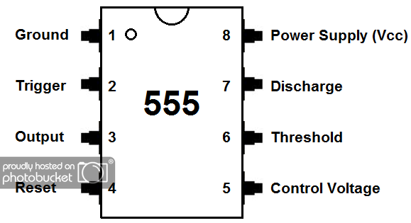

do the numbers on the 555IC in the diagram represent the pin numbers? just on the pin out there not in this order,
is it just drawn this way to make it easier to draw?
The numbers = the pins.
I've seen it drawn like that often, it confuses me too...

so this is the correct location of the numbers in the drawing?
Looks right from what I can tell... and the oddball drawing from before, I understand why.
take a look here. I guess it makes it simpler to show the internals and understand when you draw it out than to make a mess of wires to use the actual chip pinout.
