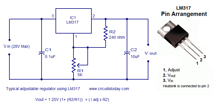

Hi everybody,
i just start playing around with electronic part. my 1st project is to make a variable voltage regulator.
Part:-
-LM317T
-220ohm & 570ohm resistor
-10uf Capacitor
-0.1uf Capacitor
-5k ohm potentiometer
my problem is why the voltage range between 1.2v to 5.4v and the potentiometer is too sensitive(1/4turn already reach Max Vout). am i doing something wrong?
Vin = 7.4v
min Vout = 1.21v
max Vout = 5.47v
how can i make the Max Vout around 6v and make the potentiometer accurate?
Hope you guys can help me to solve this problem.
Thanks.

Please show us a schematic of your circuit so we can see how the components are connected to each other.

Presumably the 220 ohm resistor is connected between the output and the sense terminal. These differ by 1.21V so the current will be 5.5mA.
To increase the voltage output, a resistor has to be connected from the sense terminal to ground which passes 5.5mA so to get an exra 2V you will need 364 ohms.
Obvously a 1k potentiometer is as big as you need.
If you only have a 7.4V supply there may not be enough to get up to the voltage you want, depending on the current drawn

miss information.
the correct one is:
-LM317T (ADJ, Vout, Vin)
-510ohm resistor (connect between ADJ & Vout)
-0.1uf capasitor (connect between Vin & GND)
-1uf capasitor (connect between Vout & GND)
-5k Potentiometer (connect between ADJ & GND)
i dont have my phone usb cable in hand. so, i hope it can help to describe the situation a bit.
is there something i need to adjust? like the resistor, capasitor or potentiometer value?
this schematic is same like mine...

From the datasheet the LM317 need a headroom of 1.5V and upwards depending on the current drawn. 5.4V @ 7.4V input is not too bad.

There is a difference from the diagram. The diagram shows R2 as 240 ohm, you have used 510 ohm. This may not be important but high value resistance here is reputed to lead to instability.
To make the potentiometer less sensitive, use a lower value.

I think you have your formula wrong. You need to swap the R1 and R2 designators around if your going to use the standard formula shown. so for 6V out it's this. Vout= 1.25*(1+2000R/540R)+(50uA*2000R) = 5.98V. So it's your R1/R2 not R2/R1 and also Iadj*(your R1) not R2.

The schematic is fine, you just need to understand the role of the variable resistor.
This sets the output voltage according to the formula given above. However, the output voltage can never be less than 1.25v (with a resistance of zero) and your input voltage less about 2 V.
In your case, let's say the input voltage is 11.1V. The maximum range of adjustment is 1.25V to 9.1V.
So you want to determine the value of resistance required to get 9V and find a potentiometer with a total resistance close to this.
If the voltage is given by 1.25*(1+ Rv/Rf) (Rv is the variable resistor and Rf is the fixed resistor)
then if we want 9V, 9 = 1.25*(1 + Rv/240)
=> (9/1.25 - 1) * 240 = Rv
=> Rv = 1488 ohms
If you could find a 1.5k pot, that would be ideal.
Incidentally, 1488 ohms is about 1/4 of 5000 and that matches well with your observation that 1/4 of a turn provided all of the adjustment.
A 1.5k pot might be hard to find, but a 1k pot will not be. With a 1k pot, reduce the value of the fixed resistor to 150 ohms and you'll be pretty close to using it's full movement.
You might like to verify what resistance is needed with 150 ohms as the fixed resistor to get 9V output, or alternatively what a 1k value will give you.

Thanks Steve.
let say i I want max Vout 5v and fully utilize the potentiometer.
I will need to replace:
Rv = 500ohm
Rf = 160ohm
am I right?.

Yep, that would be very close (certainly close enough)

No read my post again. The labels R1 and R2 are wrong to your formula.

Yes the circuit is fine but the formula is wrong to his component labels I think. Can you look again. It's a give away when Iadj is apparently flowing in his top resistor.

yes...actually i want 6v for Vout...since i was running on 7.4v for Vin and i got arond 2v drop voltage with LM317T..i think its impossible to get consistance 6v unless i raise up Vin value...
in the schematic R1 refer to Potentiometer? and R2 is fixed resistor?
please enlighten me..im new in electronic and this is my 1st project..

The R1 vs R2 confusion is why I used Rf and Rv. However you label these resistors, they have to be the right way around in the formulas or you can't calculate anything useful.

I think I worked this out for you earlier. 2000R and 540R = 5.98V
