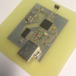

For this project to work I had to find components. My choice in prototype is Atmega32 and a lot of intelligent and addresable RGB leds WS2812b. For simple communication with PC I decided for FT232RL ( I hope to replace it soon with RQ version)
Reason for Atmega32 was to account with possible extra room for my coding trial attempts.
Biggest challenge was appropiate timing for WS2812b - however I managed to achieve it with using functions close to assembler code.
So I have came with really simple design of Atmega connected to RS232RL and using one pin of mcu to control the output for LEDs.
After couple of bad protoypes I have came with following protype ( created with thermotransfer )
