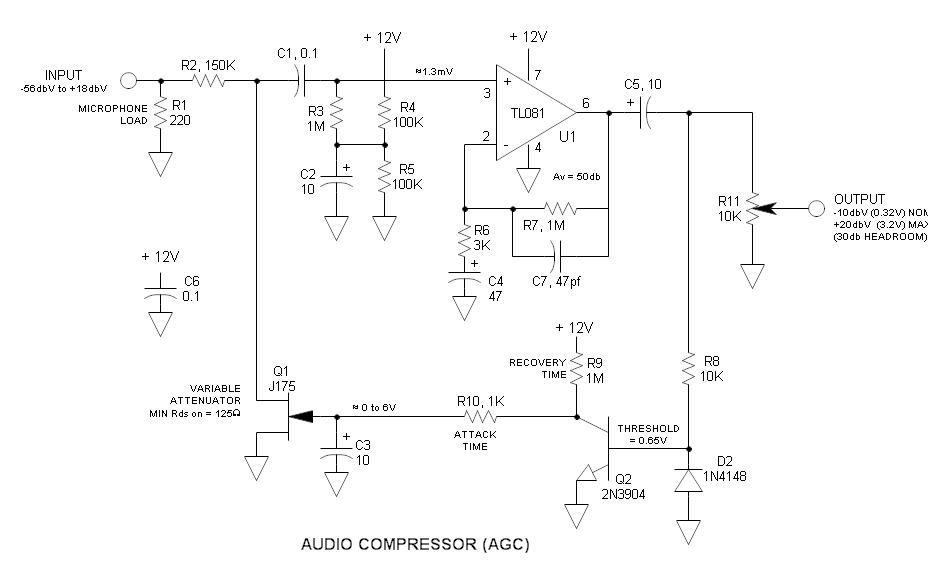

Amplification to a constant Vpp
marcusaurelius
Dec 13, 2016
8
Dec 13, 2016
8
Consider this like a voltage regulating circuit.
Think of an amplifier where the input is a sinusoidal, perhaps not in the small signal range. And that we want to amplify this signal to a certain Vpp, say for example vpp = 2. To make this a bit clearer, if the input is a sinusoidal with an amplitude of vpp=20 mV, the circuit yields vpp=2 V and if the input is say, of vpp=50mV then again it yields vpp=2 V , perhaps with a bit error.
This is kind of like regulation, except this is done is done to a sinusoidal, of varying amplitude and frequency.
Assuming the variation is not huge, say not from 10 Hz to 10 GHz or 10mV to 100 V, what sort of implementation would you suggest? I am considering to use mosfets and bjts, opamps, and p-n junction diodes, maybe some DC regulators. Is it possible to build what i speak of using such components?
Can't wait to hear your opinion.

AnalogKid
Jun 10, 2015
3,055
Jun 10, 2015
3,055
Search for audio AGC schematics or audio compressor circuits. There are hundreds out there, most of them variations on the same overall method.
Amplifier stage with a voltage-variable element somewhere in the gain-setting feedback loop or the input
Amplifier output drives a peak detector and lowpass filter
Peak detector drives the voltage-variable resistance.

Hello there!
Thank you all for your replies, they provided me with a good starting point.
First off, we say piece of cake here too^^ Although as I am on a ... kind of a diet... I've been trying to avoid cake :)
I am sorry that I haven't answered already, as this is only a part of a term-project that i am trying to build among finals and what not. I still had a lot to figure out before this issue.
So the application is that, this is something like a microphone driver. And yes, all of the information is contained in the frequency variations of the incoming signal, which is confined to a range of about 1 to 5 kHz. I don't need the data in the amplitude.
Basically, the microphone will be receiving an FM modulated sinusoidal input ; but since the distance will determine the amplitude of the incoming signal (and again, I only need the frequency), I had to find a way around this. It might still be possible to finish the project without this step, but I am also trying to learn how these things work.
I found myself a little confused when I read "phase locking an amplitude stabilized oscillator". What exactly does this mean ? I have seen the Wien Bridge oscillator before and used it once, but how exactly could it be helpful in this case? I don't know what phase locking means either. I have never studied oscillators thus far. Maybe in the near future.
And finally, I am not allowed to use ICs or audio opamps. I am only allowed to use transistors, opamps and regulators.

Now that we have more information after 14 posts ...
Microphone *amplifier*, not driver. A microphone is a signal source, so it is received/amplified/processed, not driven.
Does the output need to be a sine wave, or can it be a square wave that represents accurately the frequency of the incoming signal. If all you need is an output squarewave, then the circuit becomes much more simple - a basic comparator with 25 mV of hysteresis.

frequency is the only thing that I need from the mic's signal
Then presumably you only need to detect zero crossings of the signal, once the signal has been filtered to remove noise outside the frequency band of interest?
