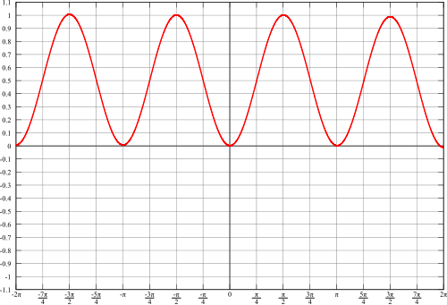

So since transistors and tubes are directional, does that mean that a crystal is not longer needed in a radio receiver circuit if the circuit has transistors and tubes in it?
So you are saying that my guitar amp is not amplifying the RF at all and only amplifing the AF that was rectified out of the RF in the first transistor?
How does any radio receiver amplify RF if transistors and tubes have rectifying properties?
So is the signal generated by my guitar pickups when I strum a string is it a sine wave that alternates from positive to negative, and when it passes through the first transistor it is rectifyed into the sine squared function which is sinusoidal but has no change of sign?
By sine squared function, I mean this:
Would a speaker still work if the audio signal was not rectified before being sent to the speaker?

Your audio signal should not be rectified at all. If it is, then something's wrong with your amplifier.
What's happening when you hear a radio station via your guitar amplifier is that the radio signal gets demodulated at the input of the guitar amp. The input of the amplifier, being "operated" far outside it's designed range of operation (frequency range, as others have explained before) works like an envelope detector. After demodulation the remaining audio signal is amplified as usual. Your speakers see an AC signal with (ideally) no DC content.
The rectification should not occur for the signals from your guitar pickup since these are within the operating range the amplifier was designed for.

Okay, so rectification is a relative term that means what ever you want to be rectified to; it doesn't have to mean rectified from AC to DC and it doesn't have to mean rectified from sine function to sine squared function. I think so, right?
So you mean if a guitar amp is converting the sine function audio signal to a sine squared function then something is wrong with the guitar amp. Actually my guitar amp does not rectify from sine function to sine squared function, at least according to the waveforms of the audio from the radio waves recorded in Audacity it does alternate between positive and negative.
So since rectification is a relative term, it would be correct to say an envelope detector performs rectification from RF to the audio envelope of the RF.
So an envelope detector is simply a passive circuit of a diode or crystal, resistor, and capacitor.
So the envelope detector equivalent that is allowing me to hear radio waves on my guitar amp is dirt on the cable contacts, the resistors in my guitar for the pots, and the capacitance of the coaxial cable.
Note that these radio waves are very quite audio in the video link and are mostly over powered by mains hum, so mostly what I hear in my guitar is mains hum and only audio from radio if I listen very closely. I opened the audio file (the same one that is in the video link) in Audacity today and added an 80Hz high pass filter to remove mains hum near 60Hz and that made a huge difference allowing me to hear the words the radio voices are saying rather than only being able to detect the presence of radio voices (when I said earlier that I heard the WBBM station identifier, I lied, what I actually heard was I recognized the radio announcer's voice even though I couldn't hear what he was saying). For example, a snippet of words from the radio announcer's voice that I can now hear are: "[female anouncer]...the internet...today...now...[now male anouncer]...inbound...12 minutes...outbound... 12 minutes..." It appears to be the traffic report by the male anouncer that followed a news report by the female announcer on something that happened on that day on the internet. Wow 12 minutes inbound and outbound on a Chicago expressway. Oh that's right I think it was 3AM when I was recording this so that is why traffic would be so light then.
Basically, Yes, this is the function of a detector diode in a radio receiver
Not quite, just the diode or crystal, not the resistor or capacitor
again not quite, possible dirty contacts may sometimes produce a diode detector function
but it will still more likely be a diode junction of a transistor or even an actual diode within the early stages of the amplifier ( probably the pre-amp stage)
No not the pots, or the capacitance of the cable. The only thing the cable can do is act like an antenna to bring the RF signal into the amplifier
no, a detector diode of some description is still needed
rectified/detected, yes maybe the first transistor or some other transistor or diode
I cant answer that specifically .... its probably not a totally simple process.
Other than to say it occurs under a certain set of circumstances
no, its not rectified, its still a complex sine wave full of the harmonics of the string(s) you have strummed
