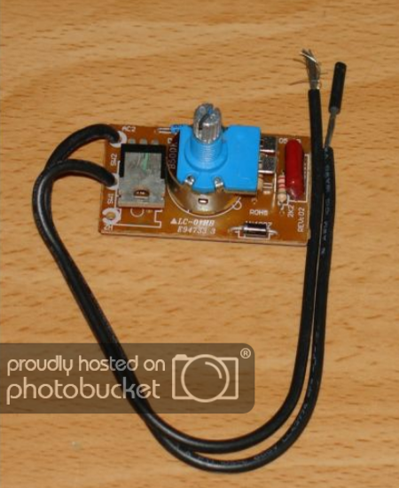

Ok. So I went online and looked up some stuff. I found this http://www.aaroncake.net/circuits/dimmer.asp the only change I think I am going to make is to change the lamp to a diac on the board. From what I've read, it seems like a better idea. So, since I've never done this before and don't really know how to read schematics or what gets soldered to what I ordered this dimmer

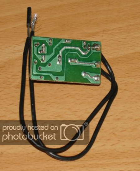

so that I could try to see what is soldered to what. My potentiometer won't be mounted directly to the board, it will be mounted with wires so that I can put the pot where I need it. Here is the back of the board with the soldering points
I have not gotten the dimmer in yet but I do have a question. On this example, do the light green areas of the board act as traces for the the electricity to flow or are they just a guide for the manufacturer? I'm sorry, I just have no idea when it comes to PCB's. If anybody wants to take the time to look at the schematic I posted and maybe put a picture together of what gets connected to what, that would be amazing. Otherwise, I will just wait til this dimmer comes in and try to figure it out myself. Again, thanks for any help, you guys have been awesome.

Yes, the light green areas on the solder side of that circuit board are areas of copper that connect the components together.
