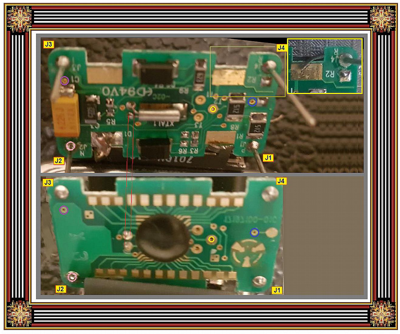

Hi all.....in the process of completing an old school tube amp. It's sounding great and I want to add a digital hour meter into the circuitry (for tube changes and other maintenance). My problem is that the only pcb style meter I have on hand is a used Curtis unit. It is a non reset version and I want to reset it to zero. I'm good with analog circuitry but out of my depth in digital. I've attached a couple pics of the unit I have here.
Is there a way via eeprom/ pc link? to get inside the ic and reset there? Thanks.....any help would be appreciated!

Modifying the hour meter you have is not possible. Under the LCD is a small microcontroller that does the counting and display management. There are no unpopulated pads that might be an in-circuit programming port, so even if you had the original program code to modify, you couldn't reprogram the device.
The meter is keeping the last count in non-volatile flash or e-squared memory so it powers up with the last value intact. Unless there is a secret handshake to trigger a reset function, you're cooked.

Ok thanks, I appreciate that advice and information. I'd like to convert the meter into a resettable unit if possible.
It is a Curtis pcb hour meter, model 701.....probably 15 years old.
As previously stated, I'm a bit out of my depth here.......the board is small and I don't even know where to look for the right chip. I read online that these units do contain eeprom chips.
I guess the pics in my post don't help - I'll try some disassembly.......

Sir . . . .(are you ?) . . . .Still buildin
Refer to the submitted CURTIS INSTRUMENTS sheet and its PARAGRAPH 4 of pages 14 and 15.
There you have the model 700 resettable unit and the model 701 unsresettable (supposedly) unit.
Ignore the following 703 model, as its just being a unit counter.
Now, one of your photos Identifies its 701 heritage.
This would be easy to ascertain if you had one of each 700 and 701 type to physically compare against.
In my analyzing the manner of construction / design you can see that there is being the running time aspect of the unit and the ADDITIONAL need of an EAROM family of memory add on for the incorporation of the data retention of the time count.
Now you read the instructions and procedure.
Then you inspect the counter . . . en toto . . . and there I am seeing 4 corner wire supports and connections and down inside the module proper, I am seeing 4 gold flashed pads. There are fine wires coming up and being soldered to them.
We can figure that two connections are going to be a given . . . . for being power connections, the others are referred to in instructions.
Now I ab-so-root-ley can't see them making TWO custom chips, when just one could suffice for being a non resettable and resettable function.
Just think of them not having installed the reset function wire connection / or / pcb foil wiring path for the non resettable function . . . . on the 701 series of meter.
On yet another of your photos . . . made of the bottom of the unit . . .
I perceive J1 as being Positive power connection ?
J2 as Negative power connection ?
J3 I . . .as Input ?
And probably the most significant . . . .
J4 as R . . .eset ?
and then there is R2 lead being just over immediately to the side.
Check out the other side of the PCB of J4 stake to see if there is being any connection that is made into it on the other side.
IF NOT . . . . . can we then be concluding, that the 700----701 product difference is being that short foil interconnect between R2 and J4 ?
(Also check out the gold pads and see if one is being without connection.)
Fill us in with your observations . . . . . .

Wow! That's brilliant......thanks!
Yes, I noticed in the data sheet at Part 4, page 15: Operation - it mentions that reset (on resettable units) is achieved by applying power to pin 4, while the same power is applied to pins 1 (V+) and 2 (V-). These are exactly as you thought, and Pin 3 is Input (labelled Enable in the PDF).
I opened the unit up a little and folded the screen display back to expose the other side. Pics here......Pin 4 is the longest, top left - does this help? Sorry, I didn't understand which gold pads you meant for me to examine....

Ok on further inspection I see that Pin J4 is foil connected only to Lead R2. No connections I can see on back side of pcb re pin 4. Lead R2 appears to be connected to nothing else.......
