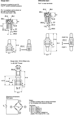

Hi,
I've got a quick question and one I'm sure you'll all know........whilst falling about the place laughing!! :)
I've got a pressure transducer and an LCD panel meter.
The pressure transducer has a + and a - Vout.
The LCD display has a + and a - Vin.
Both are 12VDC.
As I am new to electronics I understand Vin/Vout and +/- but what does it mean if there are two inputs/outputs?
Would the above be to measure -/+ pressures and hence the -/+Vin on the LCD.
I also want to use the output signal from the transducer to activate a relay...would I just use Vout+?
Many thanks in advance

You are asking a question about a device but you have not given anyone a clue as to what it is, other than a pressure transducer. There are thousands and they have lots of differences. Some have Analog voltage outputs and even these have different ranges. Then there are the current outs. There are a few of these. Next, there are the digital output types. These are used to talk directly to a microcontroller.
How about a part number? If you do not have a part number, perhaps someone can recognize what you have by the schematic used with it.

Hi MP,
Very true, it would make life a little easier.
Transducer 0-30psi:-
Similar to the compensated versions, these devices differ only in null and full scale outputs. Null exhibits a

Hi,
If anyone could help on this I would be eternally grateful as it is the last stage prior to my circuit being complete. Essentially I want the output signal/voltage of the tranducer to go to a panel meter. The transducer has a + and a - output connection and reads 330mV full scale output at 30psi. The panel meter has + and - input terminals. Can I just connect the + output of the transducer to the + input of the panel meter to read the voltage produced by the transducer on the panel meter LCD display?
Many thanks
