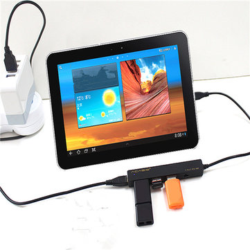

Two options...
1... find a USB splitter then feed 5v in from an externally fed 5v source..
Or
2. Cut the cable and feed 5v in

You might want to cut the 5v coming out your phone completely, leave ground/black cable alone relying on the external power source, or leave it in to charge your phone! Maybe a diode.....
